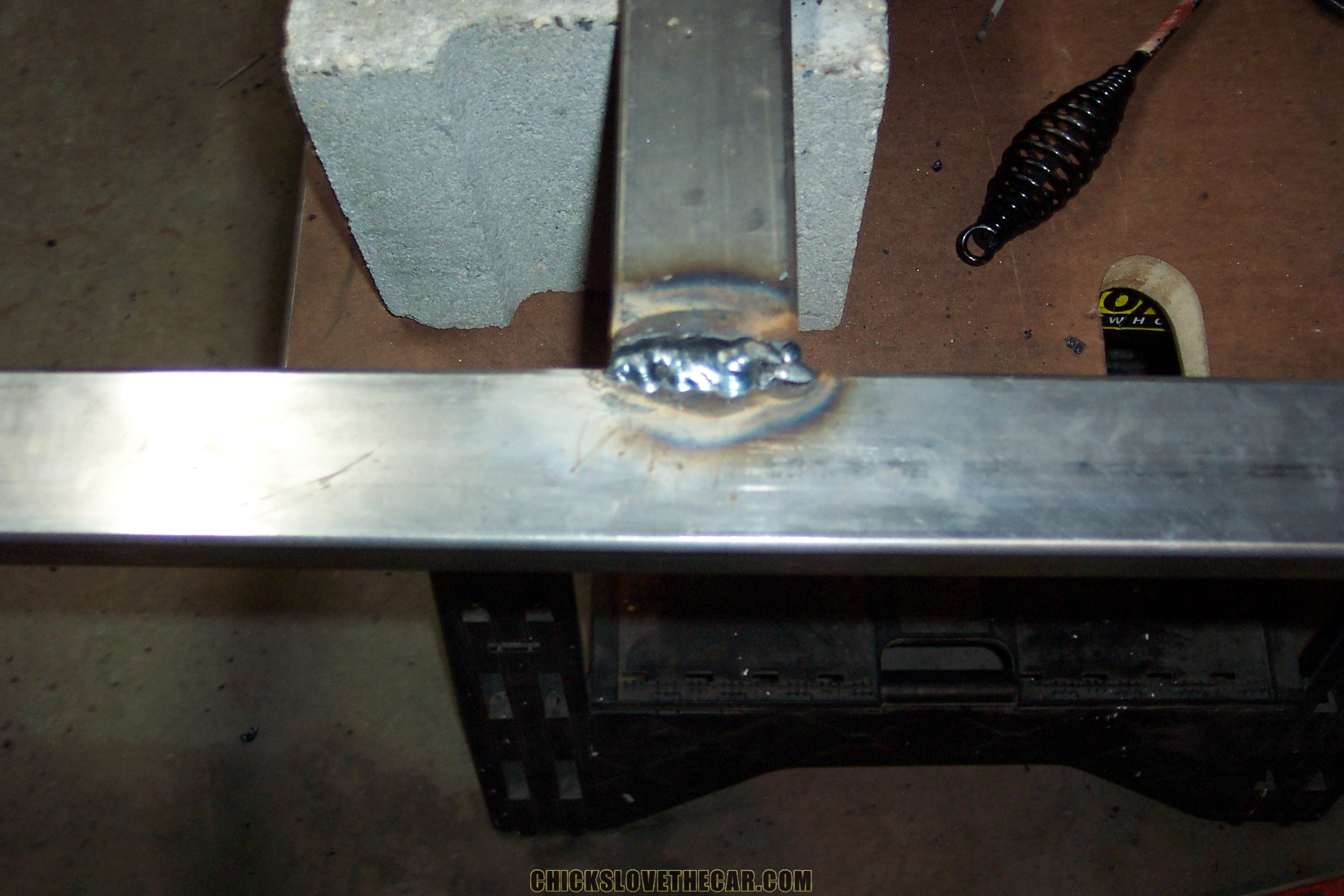

another bad one.
wavy...
too slow again. next time I'll make sure I can see better. So instead of crouching down on the ground and breaking by back, I'll raise the work and be more comfortable.
Post #65956
Posted 1/18/2008 12:18:44 AM
Getting better.
more consistent movement, but need to center on the seam more.
Post #65957
Posted 1/18/2008 12:21:56 AM
better.
centered more on the seam and good bonding. couple of small crators that will get filled.

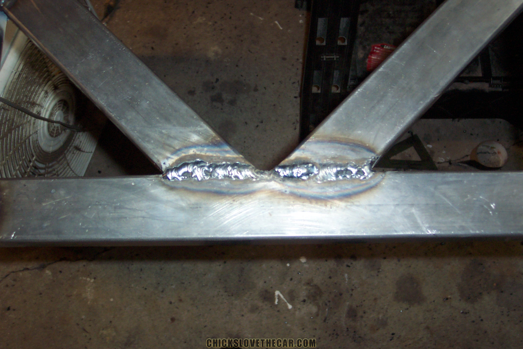

Post #65958
Posted 1/18/2008 12:23:49 AM
another good one.
Post #65959
Posted 1/18/2008 12:28:43 AM
I found that the 6013 electrode works best for me. i believe it's 5/32 ad 12" long. Short but I have the most control with it. Happy with the work and the learning. Stick is noteasy to be neat with. not for me anyway. I know that strength is more important than looks, but i feel like some welds that "look" good, look very strong and well fused.
