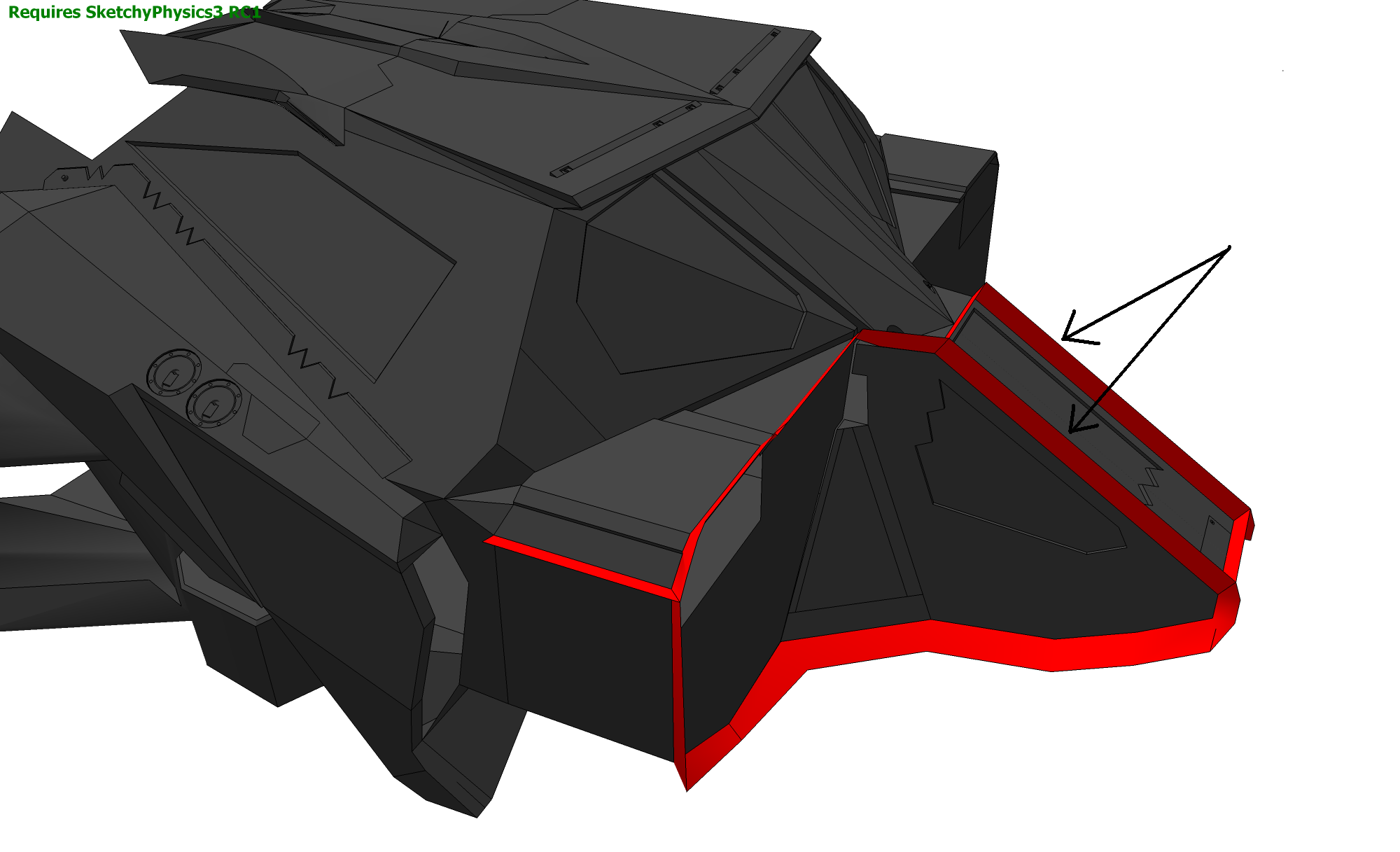

I'm playing around with this idea where i want to mold the cabin, and the the majority of the panels all as one large piece. This will highly simplify the build-a-bility of the kart, but will create a headache when it comes to figuring out the mold lines to be made for something as complex as this. lol. Good thing is I will only have to do it once. I'm thinking i might just do it.
For detail reasons there are several panels that were left off this step. They will be molded separately and attached after the cabin is created. But i will have to mold those separate parts first, THEN mold up the cabin, in that order.

Possible mold lines started. This may vary later. But i'm giving it a try.

Shaggy that looks good, but it might be better to remove the two pieces that are marked and cast the whole front surfaces.

Alrighty then. If'n you think it will do some good.

well it might, not to sure, It seems that it might be structurally stronger to have one larger piece then a few smaller, I dont know Ive never messed with the fiderglass stuff.

I've messed with fiberglass before, but not in the molding sense. So i'm accustom to it, but not with gelcoat, and bolt/unbolt sections, blah blah blah, yaddah yaddah.
