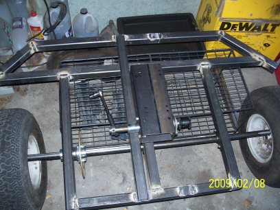

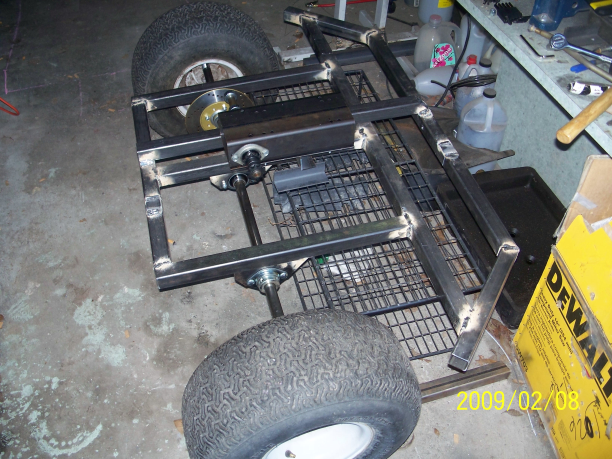

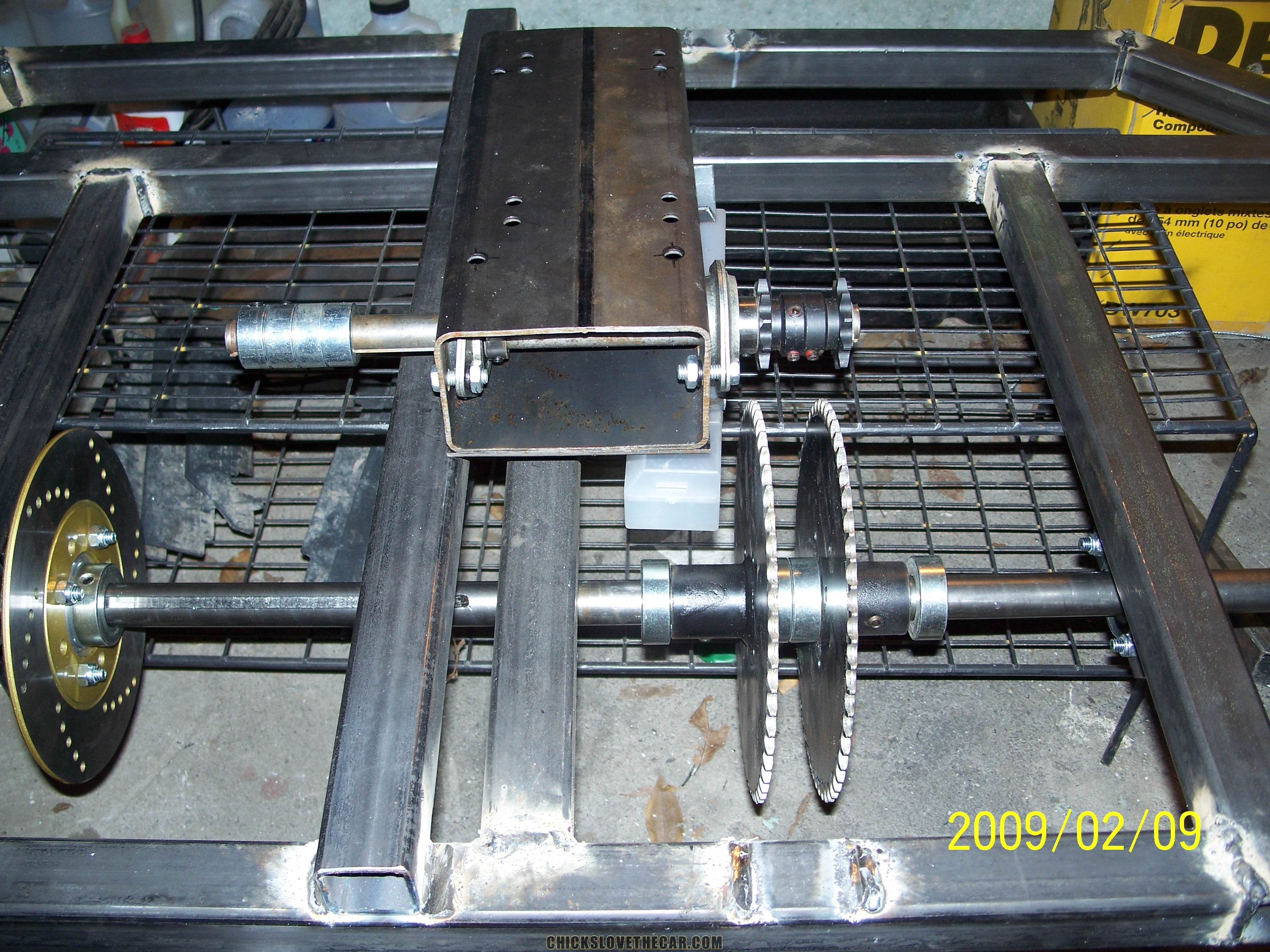

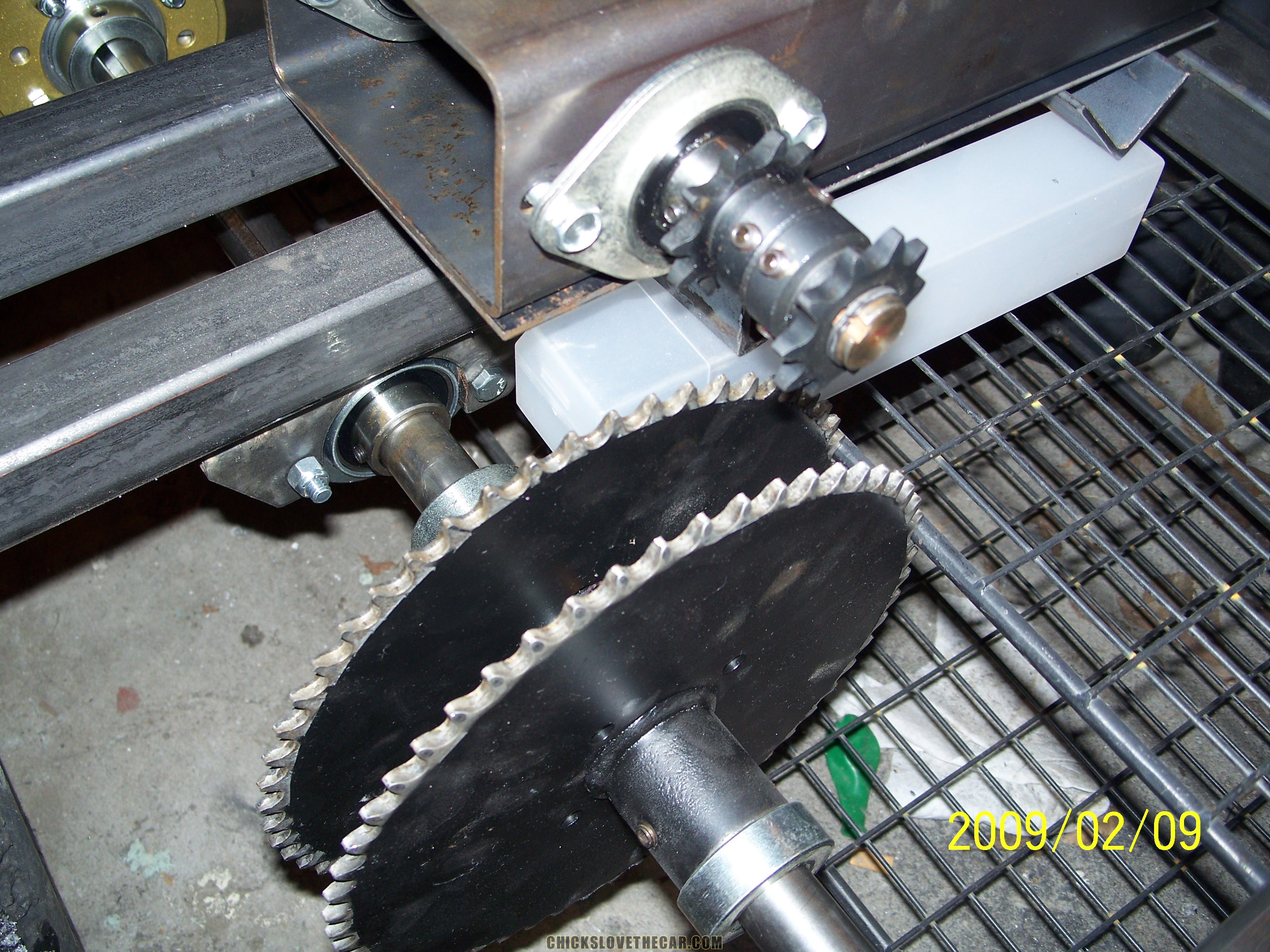

ya I know what your saying...I started out with a frame also, but as time went by (about 2 hrs) I realised that It was the out side that really mattered, so instead of working from the inside out ...were ,if I screwed up the dementions then that would propegate to the outside ...so I decided to go from the outside in....well kind of more or less it was a factor of 60% out to in, 40% in to out...I wanted to make sure that I could fit in the thing. Even as it is now ,its a tight fit. but any ways I just bought some axle sprockets,steering wheel, and a disc break caliper off of ebay last night, should be here by next wed. hopefully. Then I'll start to put the axle together. I was looking at putting a 520 size chain on it (most commonlly found on ATV's and motor cross bikes) but I couldnt find the right stuff so I decided to go with a two chain #41 setup (two axle sprockets 54tooth and two sprockets 10tooth on the jackshaft) this will give me a 1/5.4 ratio, the jackshaft will be set up with a Comet 40 series centrifical clutch, the motor 13HP. so far I have it estimated at cost $2,300 and that is without painting it.
