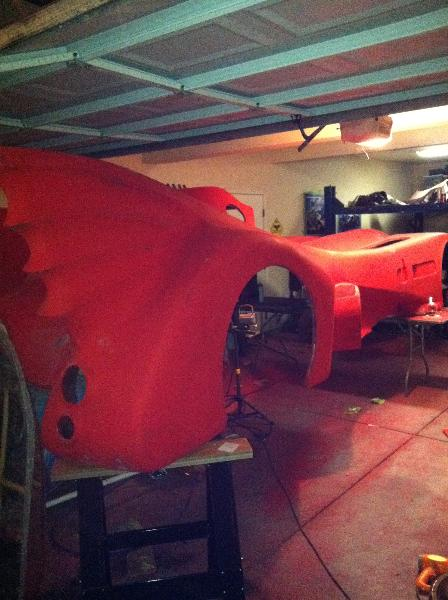

Wow that was weird we ran out of stuff to do. It was near an 8 hour day and the whole CF has been sanded. I'm filling all the holes we drilled all over the body. Did it the right way using resin and fiberglass. I really enjoy this fiberglass stuff. Got to get the canopy and engine cover finished but thats for tomorrow. Hope to get the CF up to Sacramento to be blocked sanded this upcoming week. Took some pics for you guys....BWD

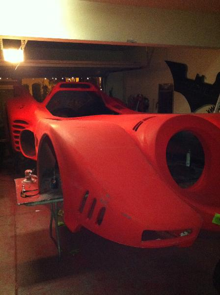

Got the body lifted high so we can get some of the underside. Usually this is NEVER seen but on the trailer I get some negative comments. But now it will look good even if the car is over your head. Im just saying.Lol...BWD

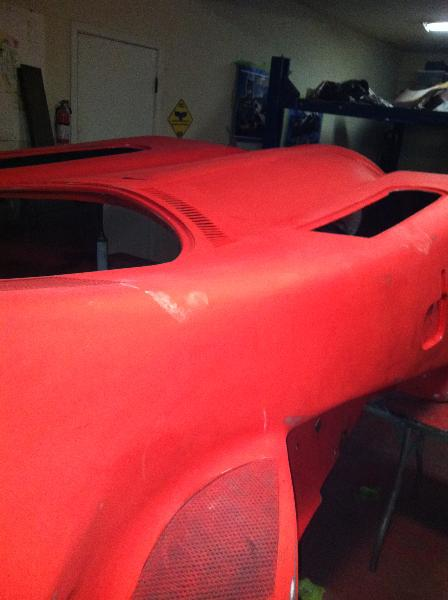

The rear wings were already done but they look even cleaner now...BWD

I've found a couple rough spots by running my hand over the body. It seems to work best wearing a latex glove. I can't wait to see what Rick says tomorrow. I will have him mark some of the areas and Rick will definitely find those spots. This is looking pretty flat.

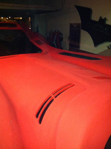

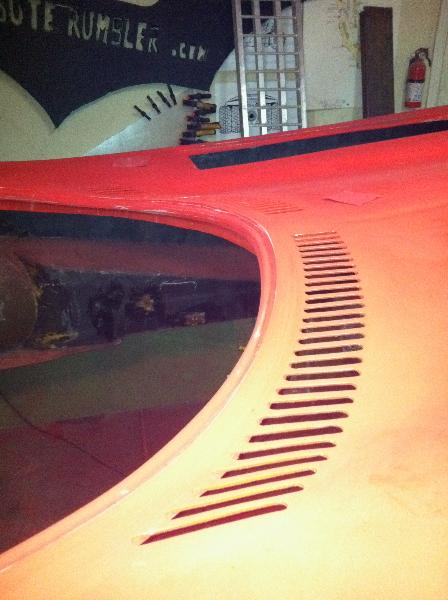

Had the metal waterjetted louvers in some recessed tray on the body but after I fiberglassed them in I could hear them pulling loose so I fabricated the louvers out of fiberglass. I think because the fiberglass and metal expand and contract at different rates it pulled loose. With them being made out of fiberglass they work a lot better. BWD

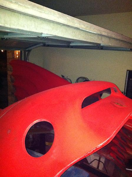

Had a major dip in the hood but we fiberglassed it in and feathered it out. With all the movement and twisting the repair looks solid....BWD

Had a major dip in the roof too. We roughened up a large area and layered fiberglass over it. With all the stress it looks good too. Thanks for looking....BWD
