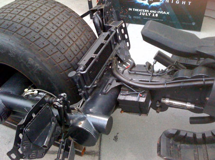

Speedwaymotors.com has the rims you need. 15x14 wheels will fit the tires as well plus, they are much easier to come by, and the look is exactly the same. I would also recommend that you buy the rims without the centers attached so that you can set the offset yourself. It will make life much easier when it comes time to mount the rims. I say this only to make sure that my mistakes won't be yours as well. PS - Shaggy's drawings will be your best friend right now, so when you have nothing else to work on, study the drawings. Also, check the pattern on your tires and verify that they are the Q pattern (Hoosier website)(I can't tell for sure from the pics but you can always swap them out if they are a different pattern) Just FYI Ready for some more pics. Best of luck to you. SDParker

We are running the 15x14 on ours and it seems fine but I would go with Hoosiers recommendation for sure. There isn't any real cost difference, just that the 15x15 may have to be custom made. As far as the pattern goes, look at this close up and you should be able to tell if it is the same. Cheers!
