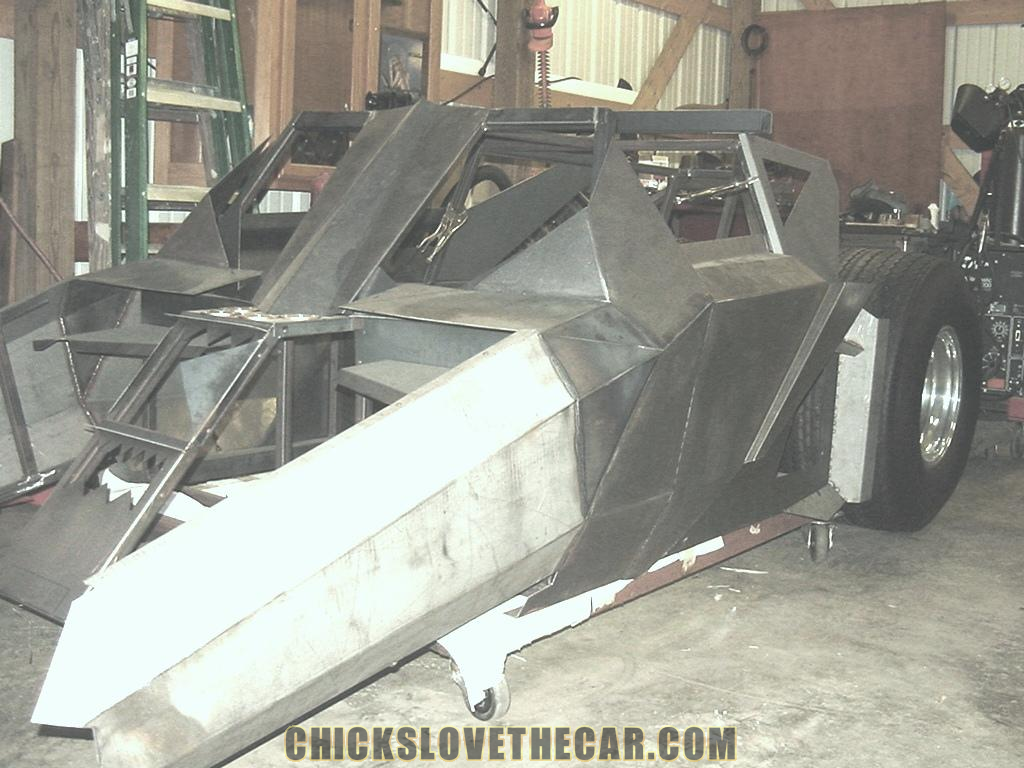

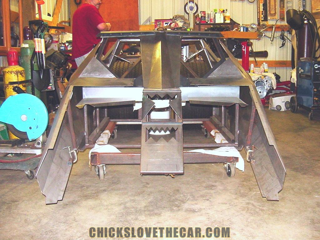

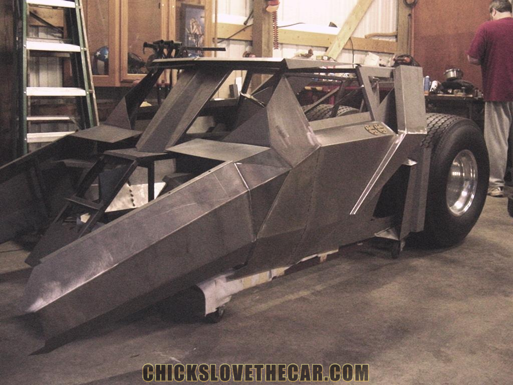

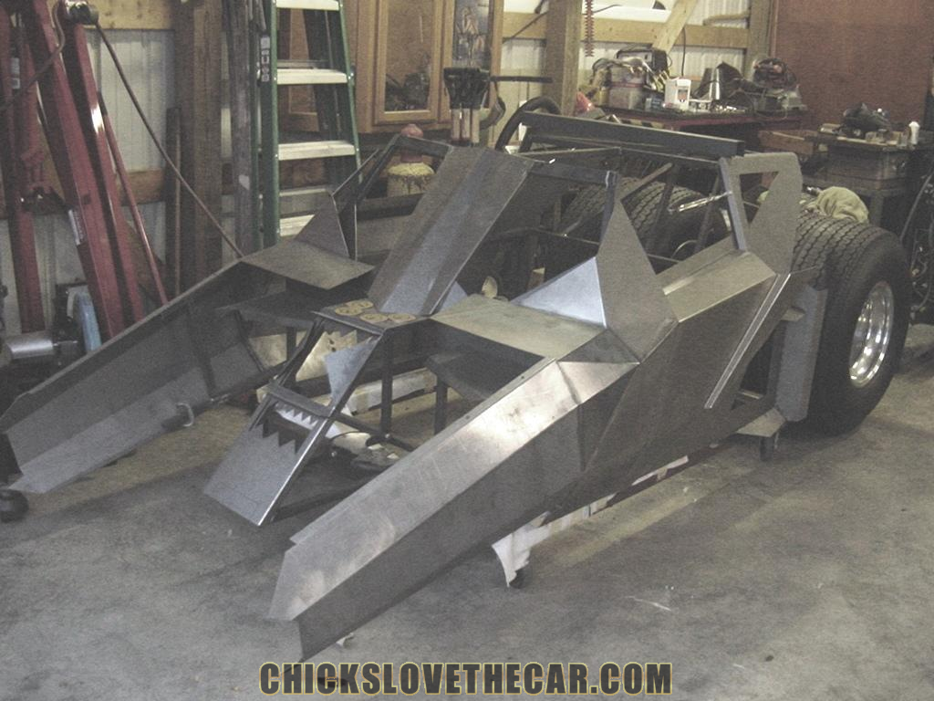

Well to start it is only 54'' from wheel outside to wheel outside, and those tires are 33/21.5x15 tires mounted on a 1 off set of 15x 18 inches wide wheels. The height is only 43 to the top and the length from claw to butt is 128".
T-man are you the u tube guy everyone here is talking about. If you are, your carts are way cool my man. Kept it up.
Any secrets for me about this bat thing . As you can see I`m kinda new at this kind of vehicle. But since I seen the movie I want one for the street.
