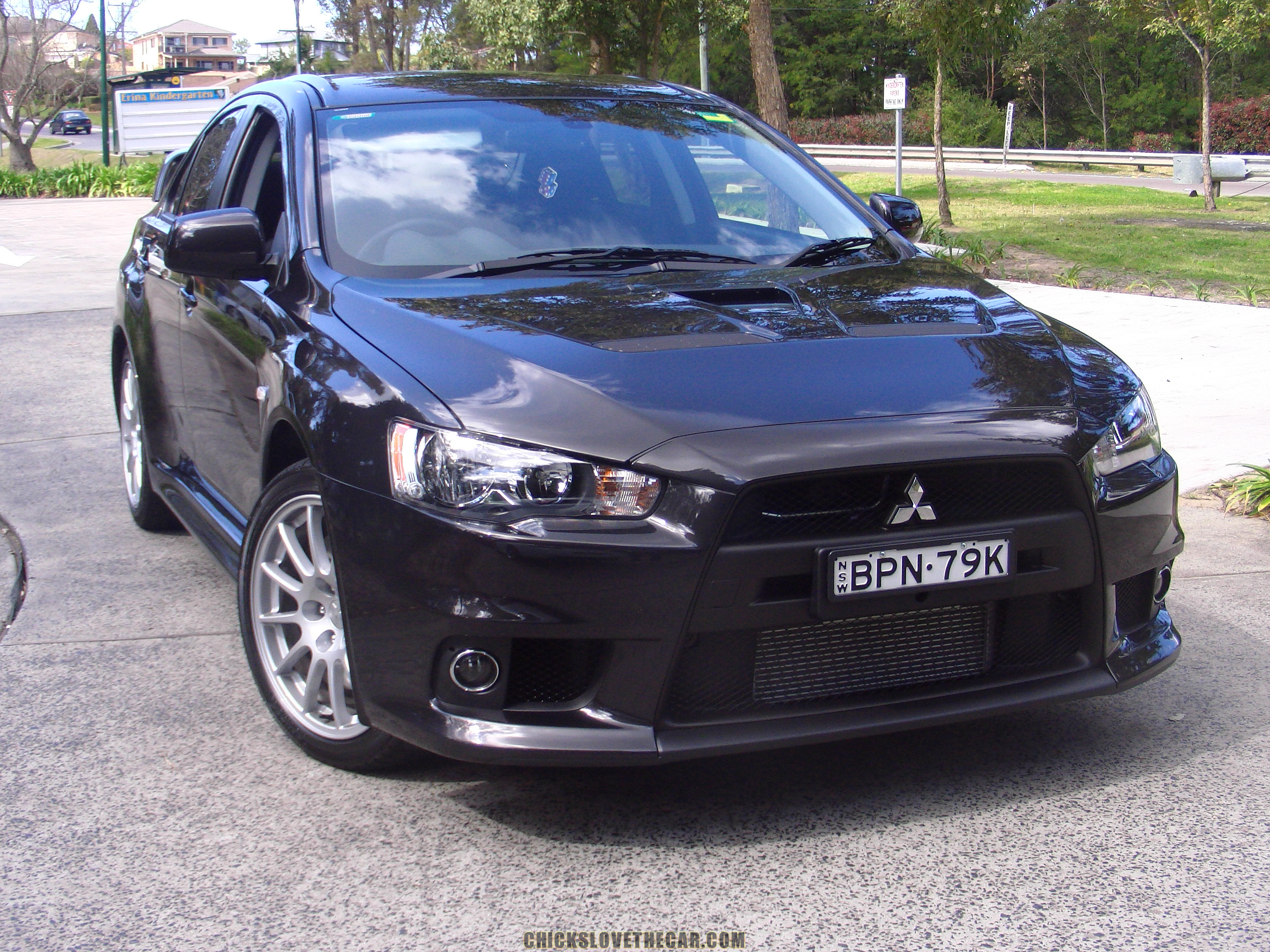

Wow its been like 7 months seen ive been on this forum and yes i still have the 89 kit but i havent touched it unfortunely. the past 7 months ive been busy with work, bought a new evo 10 so i havent spent money on the batmobile as yet. but latley i fell into some film work and im working for a company that scupltures anything so im looking fo details pics of the side mechanics and machne guns to get them to scuplture it for me. Anywhere to start looking? Oh im getting and returns costume made for me to go with me car heres a pic and a pic of my other toy hehe.
Regards richard
