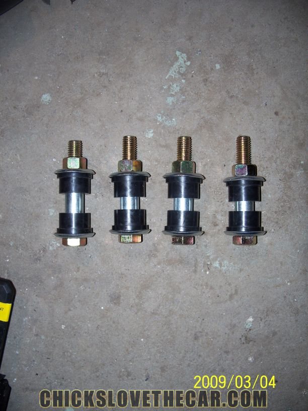

I think those dampeners are a good way to go, they're nice and simple. Nice to see you moving right along on your build. So by monday we should be seeing some body panels right?

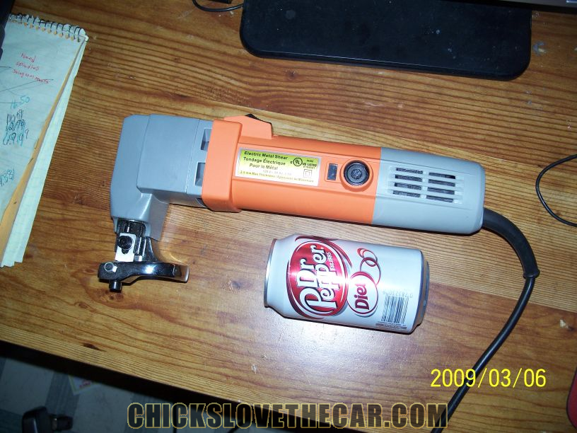

after that I realised that I had a piece of 18 g sheet metal that was sitting behind a bunch of cardboard so I pulled it out and took some measurements and started to cut with my new sheet metal cutter ...what a pain that was...
