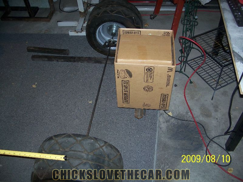

I'm all ready thinking of my next kart ...The C-kart
its going to be 50" x 50" squair from the center point of all the tires( point of contact with the ground) and I'm thinking of placing the motor Behind the rear axle..the box
what do you guys think of that wierd a$$ idea..

Alright T-man, put the front tires back on the tumbler! What is a C-kart?

ha.. yep those are off the front of the T-kart ..well I have it in mind to initially make 4  primary karts the T, the A, and two C karts. standing for T=Tully, A=Alycia, C=Cristal, and C-Cody..... T-mans T.A.C.C. Karts or maby I should call it the Robin Rod
