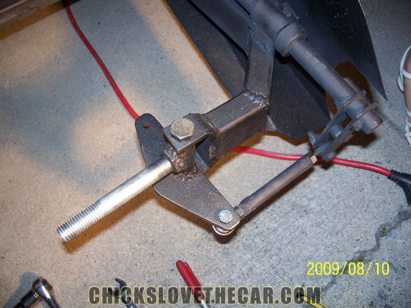

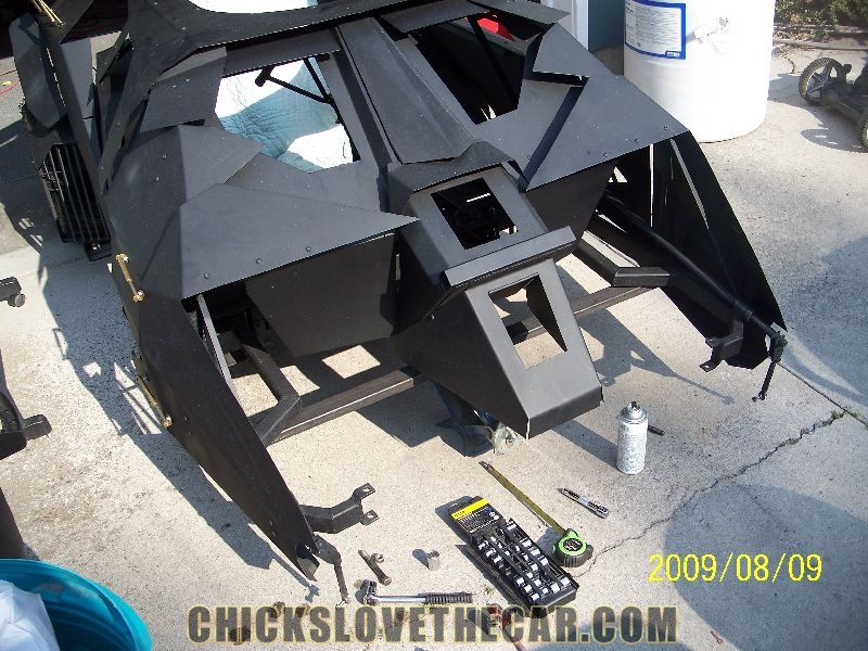

Posted 8/10/2009 4:11:23 AM
Well I have decided to implament the Akerman turning in to it...took the front wheel off and stearted to measure....
It looks like I'm going to build a whole new spindle and set the tie rod connection out by about 5/8 ...
I think I'm doing this right....I hope

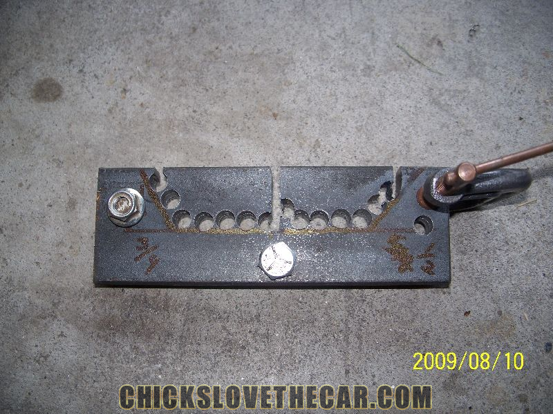

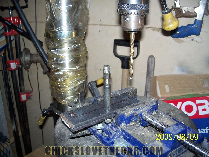

Posted 8/11/2009 5:00:47 AM
well this is what I did today ...I first fallowed the pattern of my plans and drilled the center king pin hole...then placed the old spindle over the new flat stock and measured out the new tie rod holes and drilled...
then drew in some lines that would show me what to get rid of and put it on the drill press.
then brought it to the chop saw and cut some grooves
clamped it to the table and pulled out the hammer of THOR and started pounding...(that was a great stress reliever)
then pulled out the grinder and smoothend things up.
the other end is something that I'm testing . start welding tomarrow
