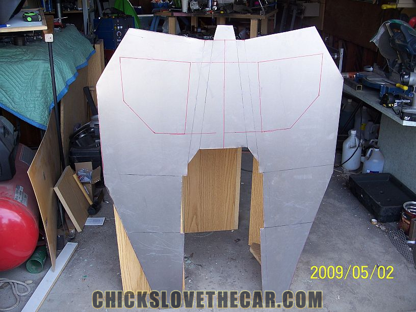

Posted 5/3/2009 3:35:06 AM
Ok... I cut out the front face except for the windows that will be don after the bends. Then I marked out the top and cut that out, Mon. I'll take these down and have them bent, so they should be on bytue. or wed....hopefully

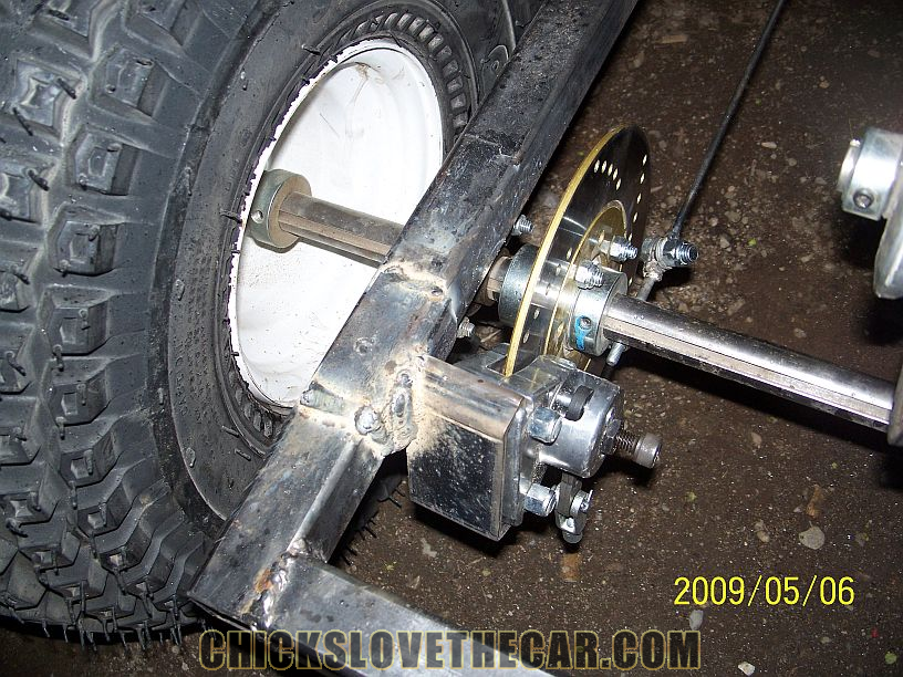

Posted 5/6/2009 12:49:00 AM
All right I got my break caliper in today....
These next pics. show the difference in the old one (left) and the new one (right)
I went over to my other cart and noticed that the break is the same. Chances are this is what conrad has on his temporary rear.

Posted 5/7/2009 2:28:55 AM
awesome ...I got THE CALL ( your panels are done) ...went and got them, came back home, in this picture they are just sitting in place, no mounts yet, thats tomarrow.

Posted 5/7/2009 4:46:37 PM
Hey T! looks GREAT! My brake on the Manco kart I have rigged to the back of my frame is actuallu a drum style brake. I like the discs though...the new piece you got looks massive compared to the other one. wow...very nice...the golf kart axle i'm going to use will have drum brakes for each wheel.

Posted 5/8/2009 2:26:29 AM
ya Terry I know what your saying on the camera we have one that uses those little vhs tapes....I was thinking of doing an inclosed cab at first too, but I came across something on the net where some one was talking about what the tumbler was like to drive and they said that it was terrible the turning radious sucked when going slow and theres so many blind spots that you have to keep moving to look out the windows and that makes the drive vary uneventfull. So I then decided to do the cut in the top...but what you might want to do is the sections of the paneling that would be in the way of you vision you could make those areas out of a dark plexyglass/acrilic it would be more work but safer when your driving all those birthday kids around (you know they'll want a ride) ...ya I was thinking that you would be the only batman birthday entertainer with a tumbler..wow you would be having all sorts of calls, hell the parents would want rides too...oh..when you start to work on the panels useing sheet metal DO NOT HAVE ANY GOOD CLOTHES ON ..I have gone through two paires of pants and three shirts..its almost like this stuff reaches out and grabs you.
but anyways this is what I did to day...I first cut, welded, drilled and tapt on the piece of angle iron thats going to hold the rap-a-round(bottom) of the face panel.
then I just added an extentions to the stand-offs hear and there
this front panel was the worst so far...my hands are all scratched up...gloves were a hinderance so I had to bare hand it.
