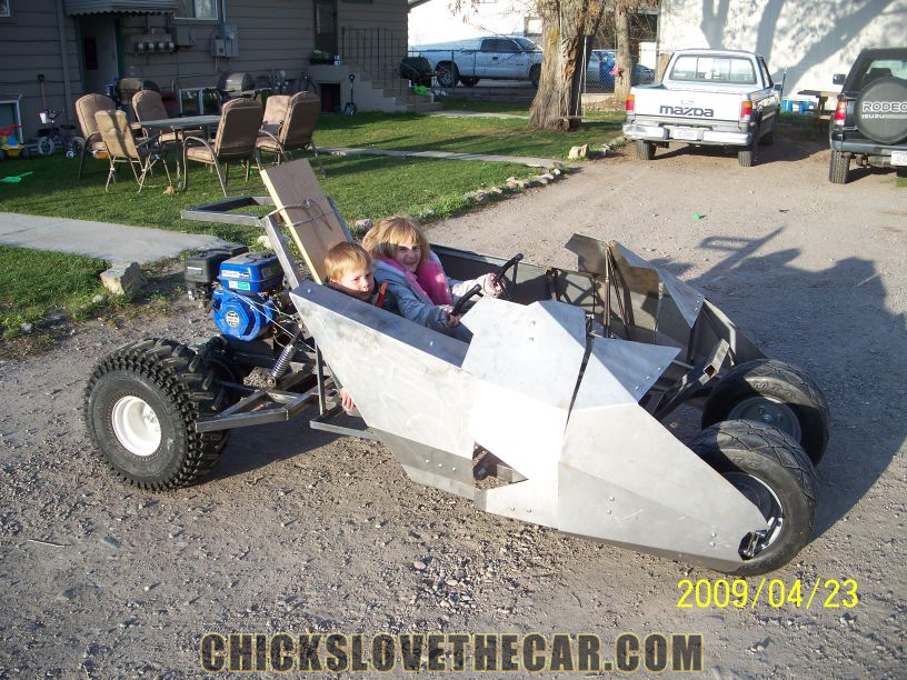

Today I didn't do much I built the steps that will go under the panels on both sides and put a little bracing on to set it. tomarrow I'm going to try and get the other panel on and then re-enforce the steps.

well today I went out and did the other side and step ..it didn't line up as well as the other side but I just manhandled it a little and it worked.
don't know why it came out fuzzy looking....these next ones are from the topdown from the back and the other is from th front.
I took the front panels off because I went out and drove it to see how well the panels worked ...and man I tell you what , I think everyone in the neighborhood could hear me coming and going...they rattled alot and loud...so I pulled off the front arm pannels and started to put exrta bracing on and then I ran out of welding wire, So I'm going to have to finish up tomarrow after getting a new spool of .035.

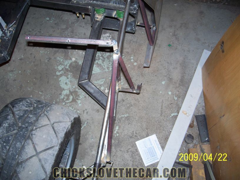

ah oh ...I forgot to put these pic. in with the last ones. These are some of the extra bracing that I applied.

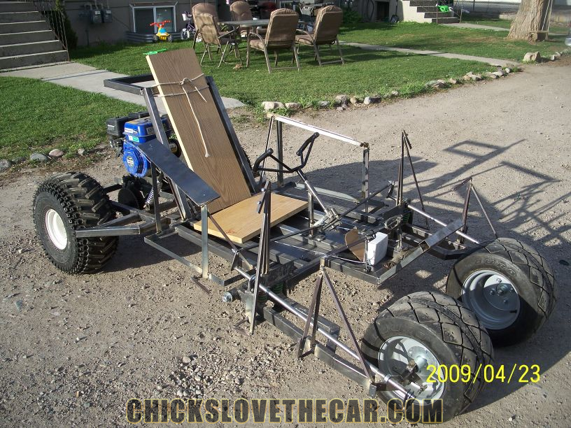

Well today all I did was reinforce the paneling stand-offs
BEFOR: no panels
After: with panels (and kids)
I'm not sure if I should work on the front face or the rest of the sides ....hhhmmmm
