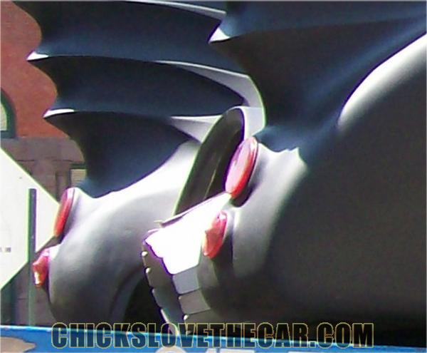

  2. The front turbine housing was a cheap $9.95 orange plastic flower pot painted, and centered with door stops. Not attached with the door stops. Attachment was via a couple of brackets riveted to the plastic electric fan housing web. The base of the flower pot was caulked into place in the afterburner to hide the fact that it was not completed per the contract. Photos of the door stops are on my CLTC build log. The turbine housing broke loose during transport. Again MT blames the transport company for this failure. The welds on the Afterburner attachment bracket failed as well. There was no professional craftsmanship, materials or supplies evident here as stipulated in the contract.

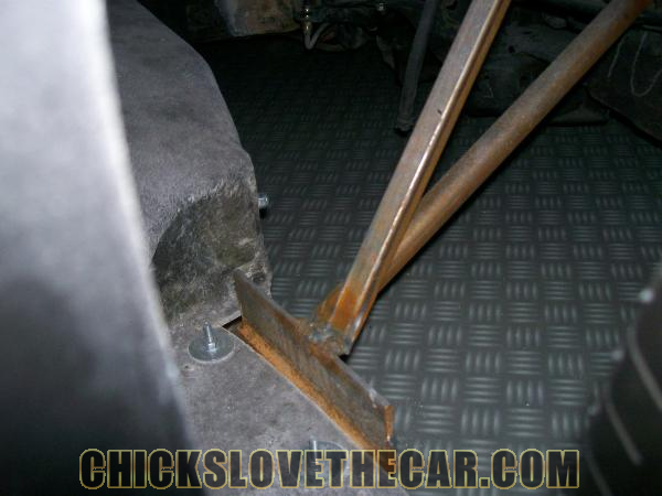

7. MT did meet this obligation. Was the mounting done properly? In my opinion no!  The following photos show a couple of the body mounts. There is no reason to show any additional photos. It only gets worse. Within a 1000 street miles, there would multiple failures. Now this is just my opinion as there is no way I am going to test my theory. Actually I can’t test this theory as will become evident within the next numerical paragraph.

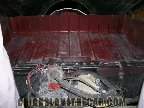

8. I am going to quote the entire obligation of the contract. “Vehicle must move under its own power” Well for starters, I will take you back to the beginning with regards to the “roller” issue. Had the front wheel been undamaged, there was and still is no way my Batmobile is going to move under its own power. There is no gas tank, and no battery.

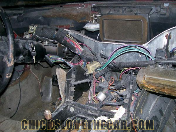

And because of the damage done to the original corvette dash during the build, I can say there are electrical issues far beyond the lack of a battery. A photo of the dash as delivered to follow. It was agreed MT would not be doing the interior, but to leave the customer with this? He could have cleaned up the building trash or at least hit it with a little air to blow off some of his dust. Amateurish and typical of his building practices

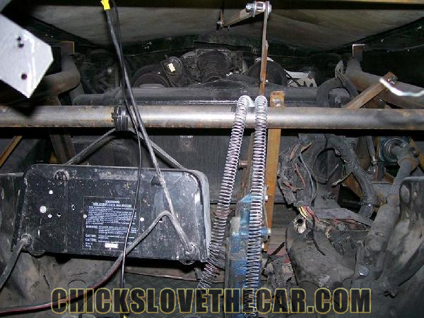

9. I suppose MT gets this one in a round about way. As there is no battery, the only way the canopy opens under its own power is that MT hooked up an old battery charger that requires 110V to power the contraption that operates the canopy. The switch that operates the canopy just hangs by its own wires in the RF wheel well and is difficult to access. Here is a photo.

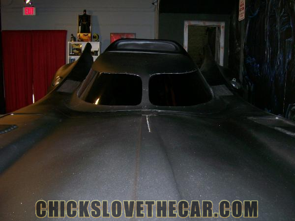

Kory: “You did not pay for paint” No I did not and in fact ask you not to paint it as I had a body shop here and a team of experts to paint the car. Oh, they have a paint booth. The paint job has as much debris in it as pigment. The following picture shows the quality of a small area of paint. Can you see the primer? No MT & Kory it is not the camera. Good thing I didn’t pay for paint, it would have been one more of many disappointments!
