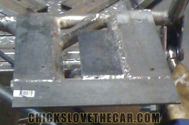

So with that I went to mount the motor. Whoops...before I do that i better run back to the Cart place for a belt. i don't want the drive and driven wheel to be too far apart and have problems getting something to fit. I've read stories of guys using snowmobile belts cause theyre long. I'm just trying to use what the equipment was intended to be used with. I want the belt that is "recommended for use with the yamaha g11 axle/ transmission for gas carts".
I found a comet 40 tourque cnvtr that fit's the Honda's keyed shaft perfectly...I looked at the cnvtrs on the other golf carts and they're HUGE. the tech there said that "ya seen one, ya seen 'em all" and told me the comet was good for my use (although i don't think he remembers the size of the rear tires).
so i got the belt and headed back to size up the mounting holes on my engine platform. before I had the belt i never really knew exactly where the engine would mount.
here's the mount before
Post #77938

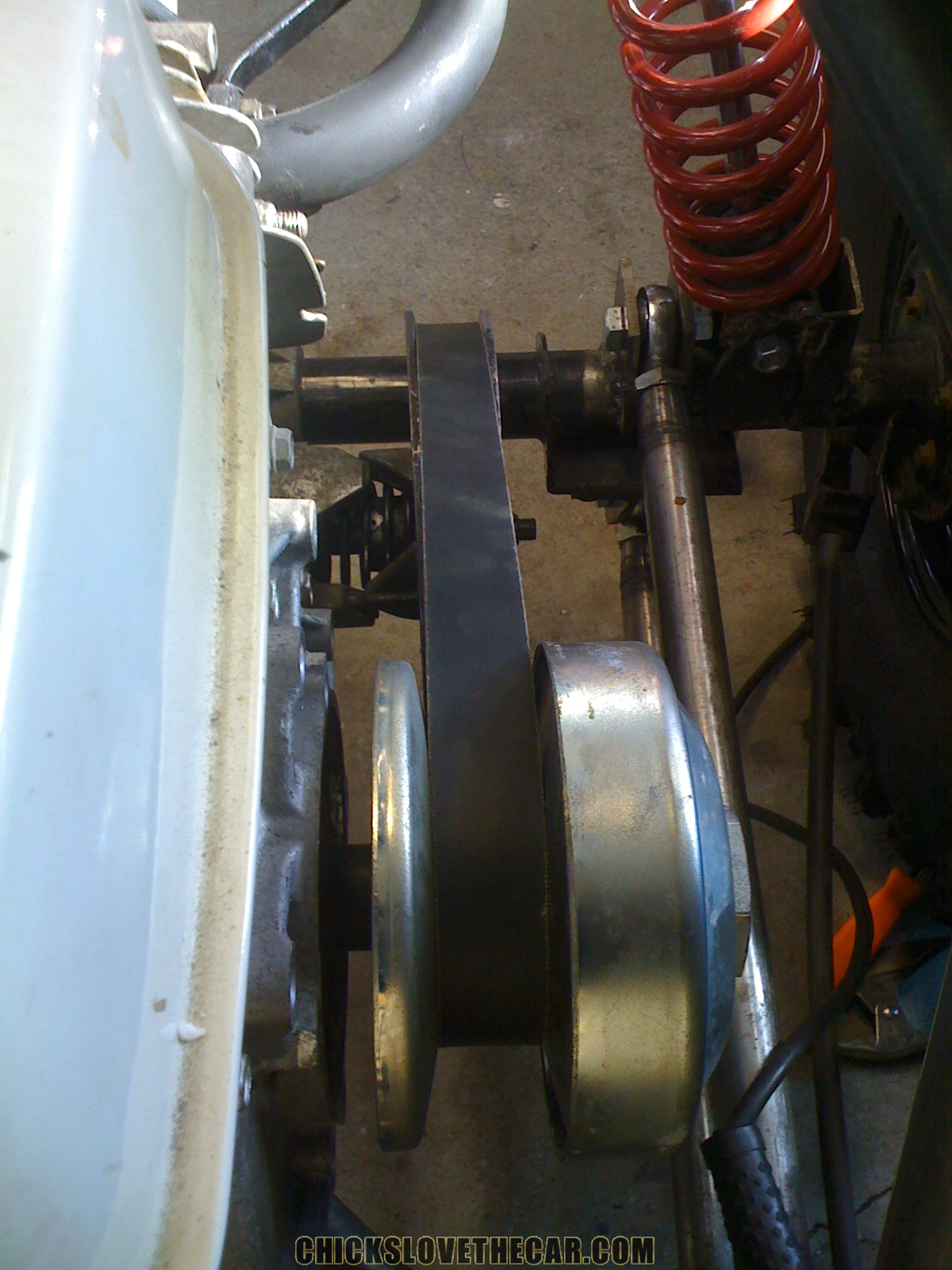

Posted 1/6/2010 11:54:27 PM
after..
The belt length (laid out) is 41". I had to exted the engine back more to get lined up with the driven wheel on the axle.

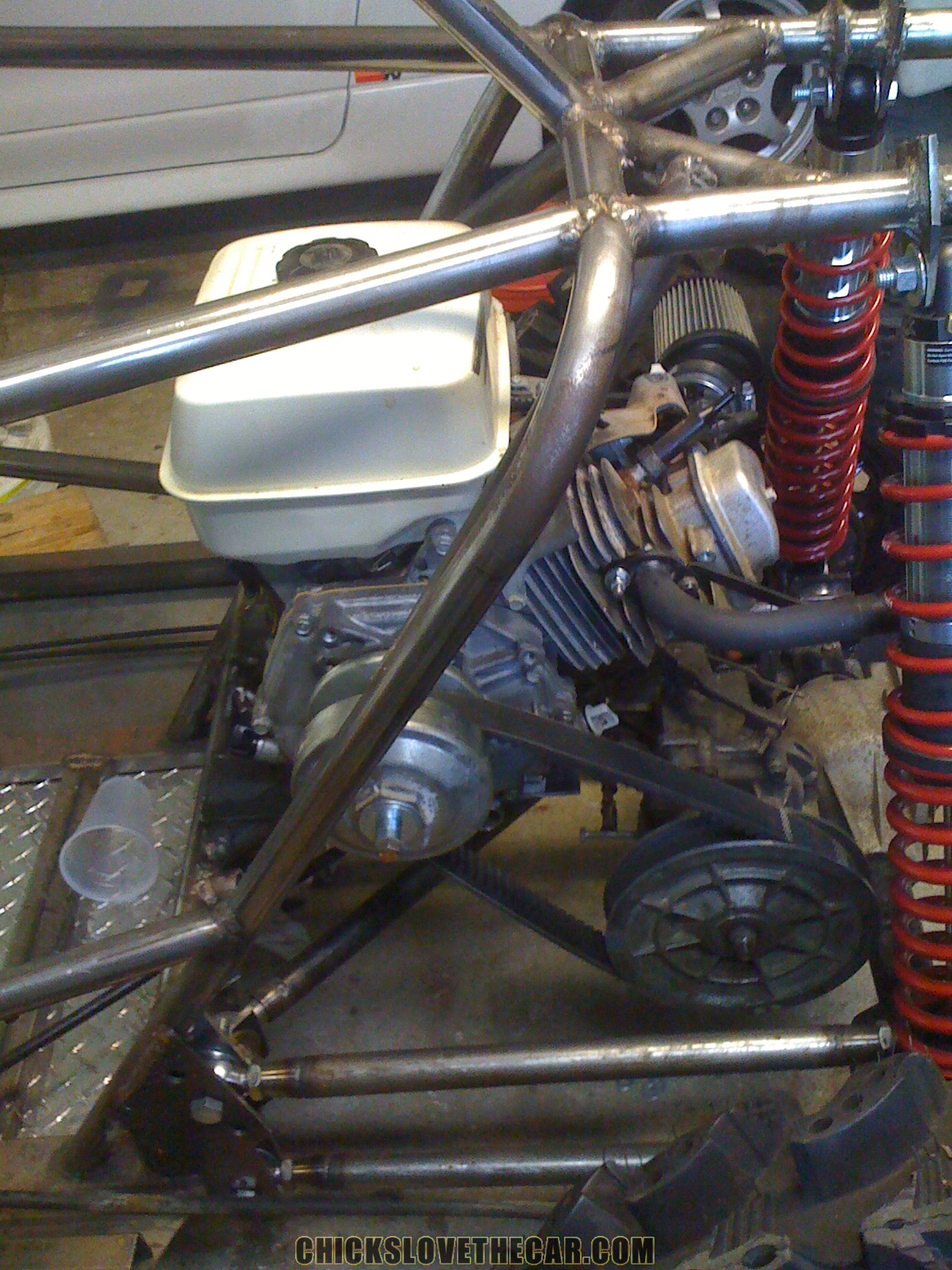

Posted 1/7/2010 12:04:10 AM
more pics of the engine with belt on
Post #77940
Posted 1/7/2010 12:14:32 AM
luckily i got the angled air filter...the carb stops just short of the right shock...
So wow...wait, iThought...this thing is very close to moving on it's own. I got the jack stands, bolted down the motor (and tourque cnvtr) and started the engine.the wheels didn't move at all which scared me. then i realized this isn't the go cart. I had a transmisiion and the shifter was set to netural.
COOL. so i began playing with the shifter which sounds like it locks in to forward and reverse hard but not as hard as i expected. it just sounds like it locks into gear and goes. I sat in while it was idling to see how the rear brakes did. well, the right wheel stopped but the left took some pushing of the pedal. I still have my front brakes working so will get those setup.
Post #77941
