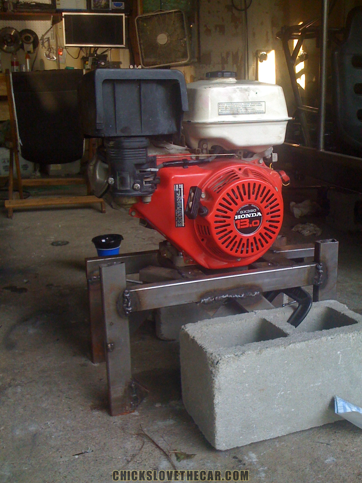

and on another note...after adding oil, gas and fiddling with the throttle a bit this engine started for the first time after 8 pulls. now that it's warm it starts on 1 or 2 pulls. sounds pretty good to (stock anyway).
