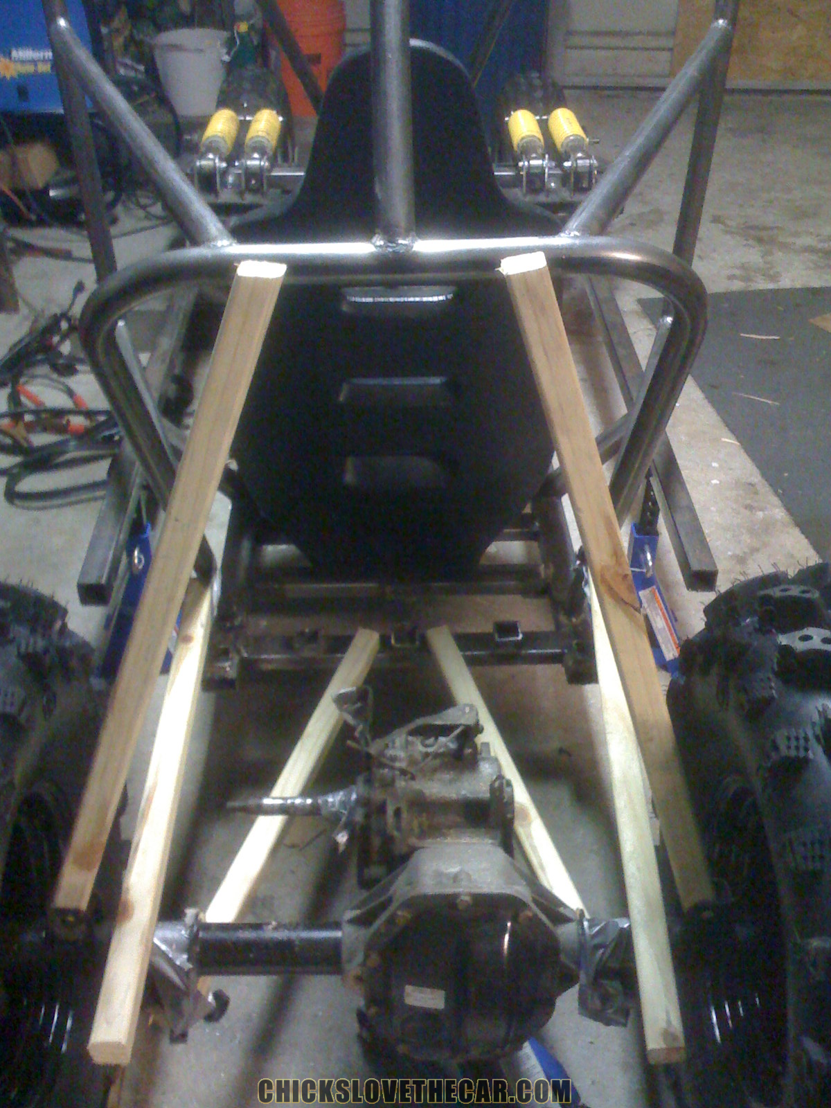

options for rear shocks and 4link
Post #75355

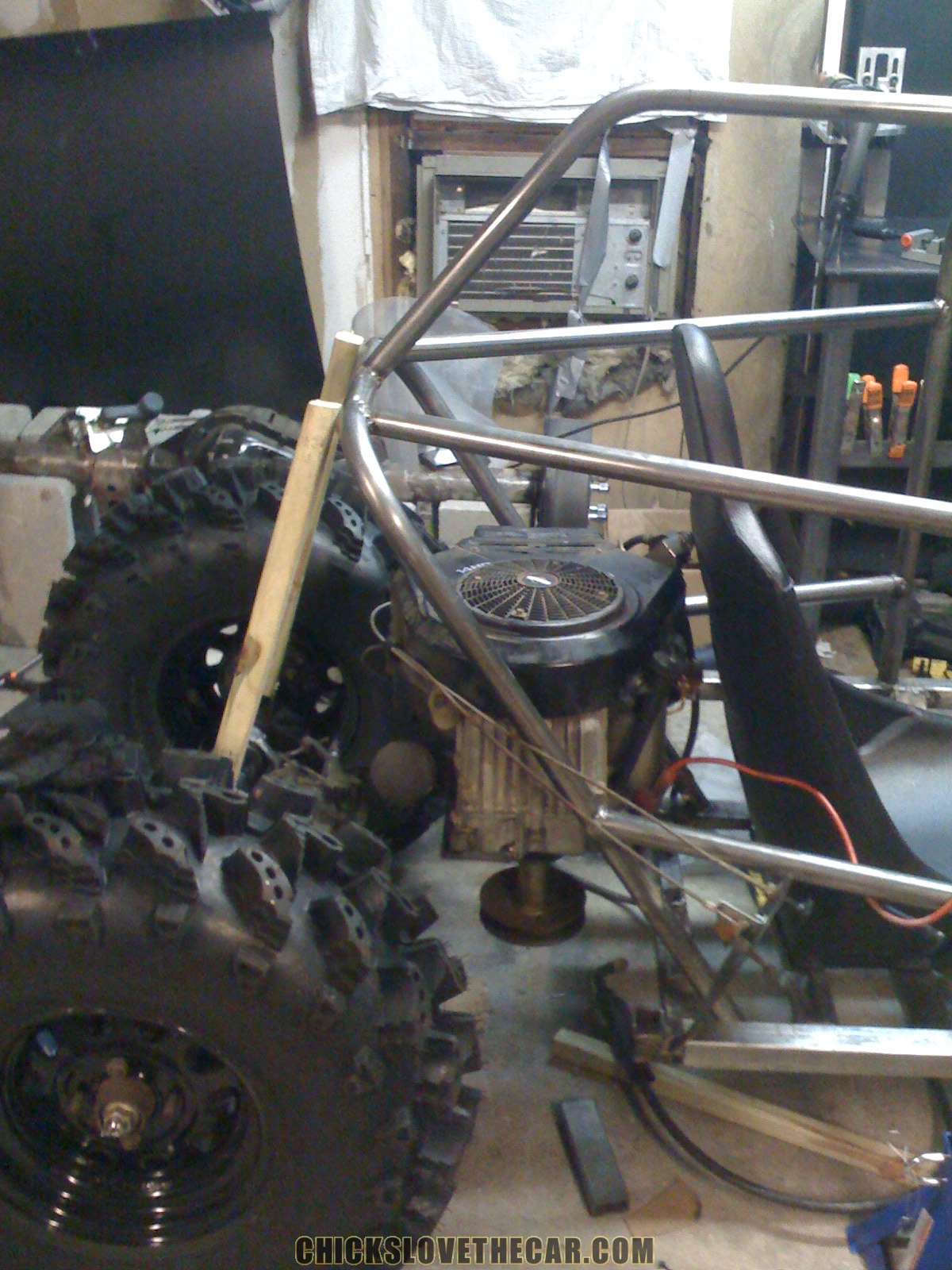

Posted 5/31/2009 11:07:35 PM
motor mount
the placement for this mount was done with the hondGX620 motor in mind, should I decide (and afford) to spring for it.

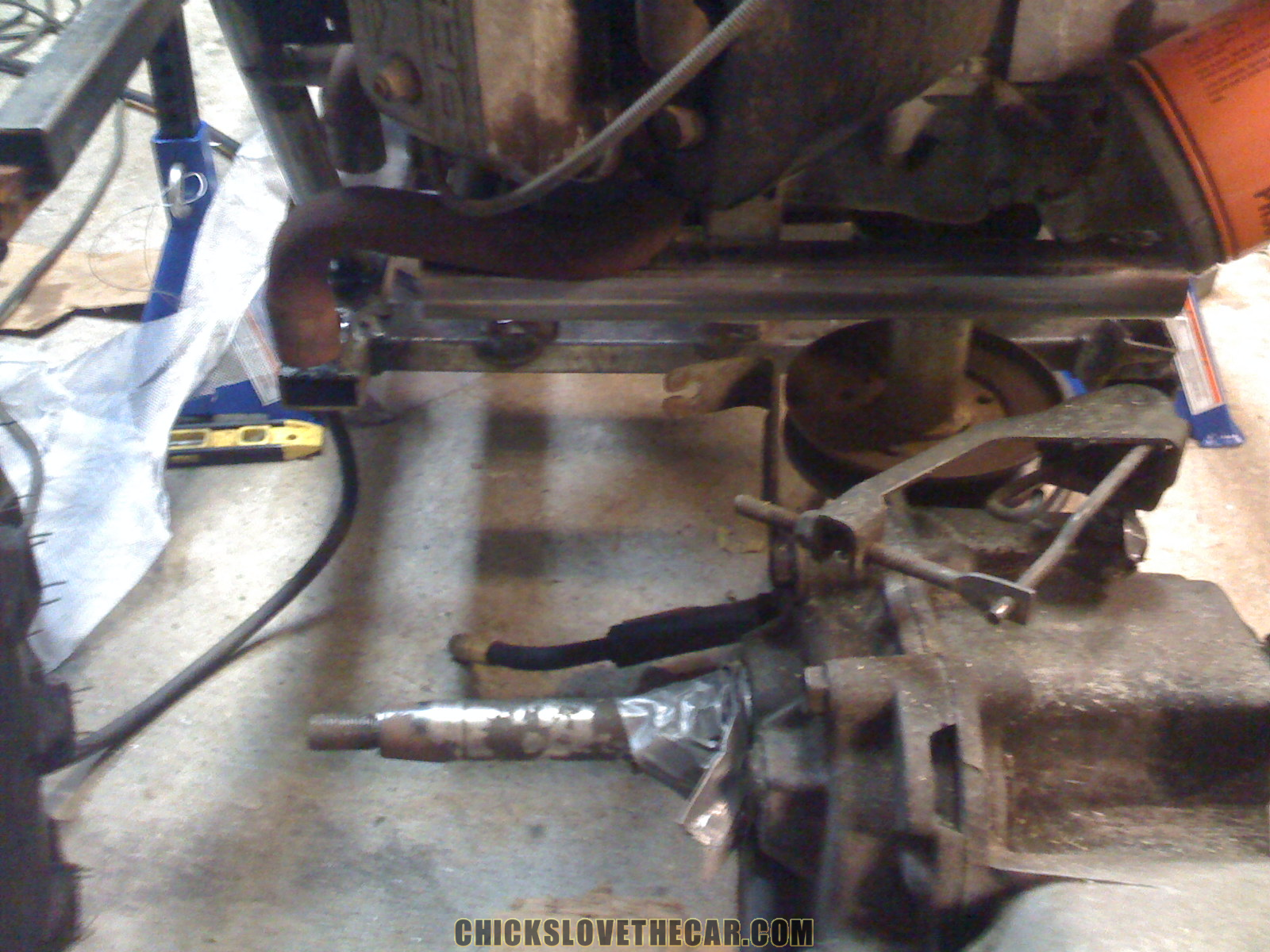

Posted 5/31/2009 11:16:22 PM
here's the briggs and stratton's general position on the mount. the vertical shaft has a belt pully on it now, but that will be coming off in the coming days. you can see from the picture how the extra gears and shaft will line up with the transmission shaft.

Posted 6/1/2009 4:54:34 AM
hay C that moter sounds awesome but I couldn't tell you whats wrong exacly but I'll ask my neighber next time I see him, he works on small motors at work....but I am concerned about your set-up for the moter mount...as a rule of thumb you want to mount the motor to the frame of the rear, for two reasons  1) so you dont get any flexing in the chain. 2) with the motor bouncing around it helps the oil slosh around and lub things up better. If you could ,draw up a simple sketch and scan it, then post it, I wana see your plan...I would hate to see you put so much time and work in to it and something  snaps and breaks on the first test.

Posted 6/1/2009 6:13:28 PM
Hey Max...yeah...no muffler...maybe I should keep it that way? haha
T-Man...I think you said the motor mount should be mounted to the frame....well i'm not quite done with all the bracing but that was my intention....to mount it to the round tubing and have additional support bars going down to the frame.
