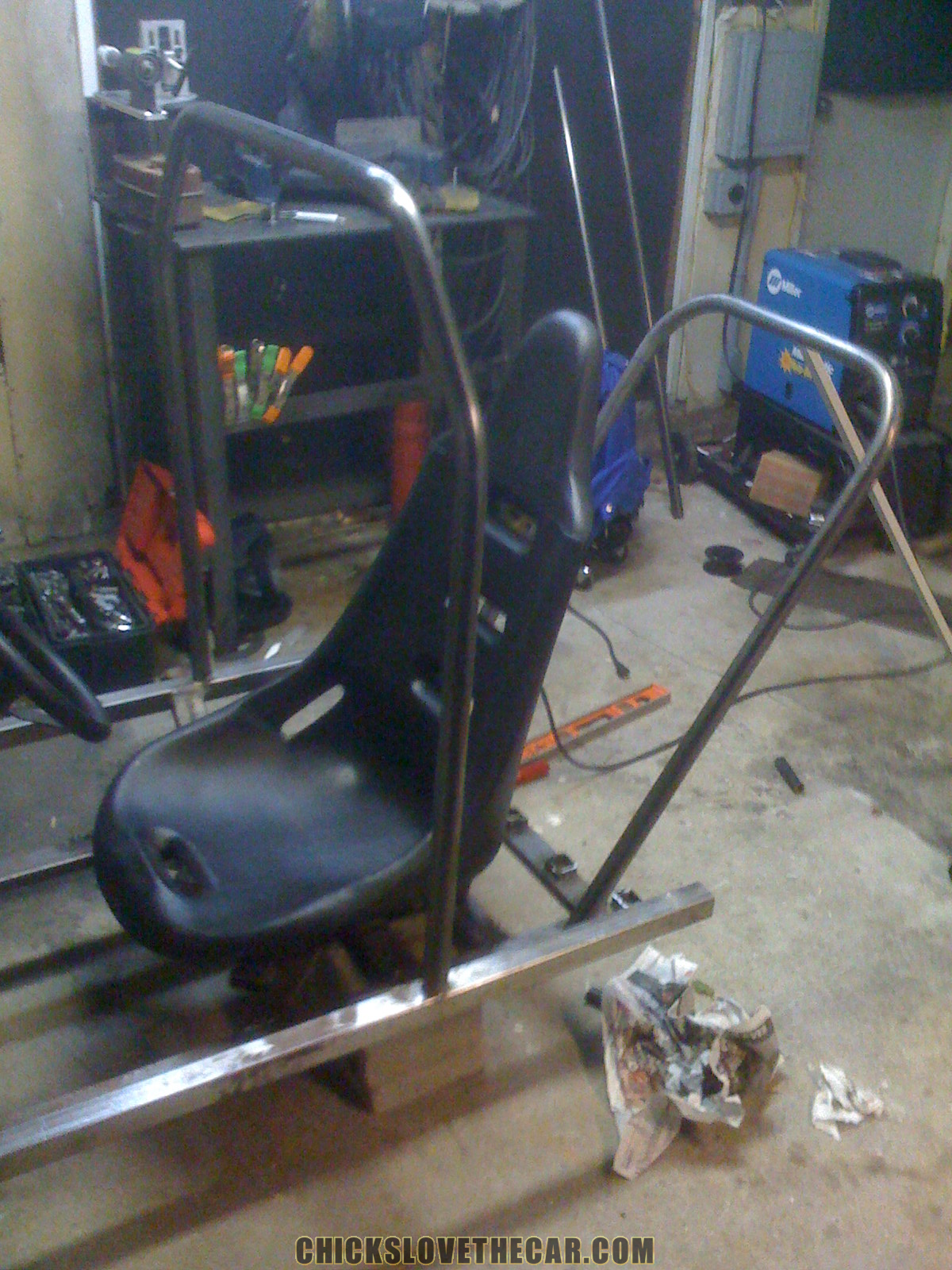

Thanks Dave! I'm learning from the GREATS! T-Man...I appreciate the words...coming from guys like you it's super encouraging. I am still learning as I go. Well i got my first set of round tubing bent.
so it's bye bye Manco Rear..
There's my 12 year old mutt walkin by..Time to fit and tack the hoops..

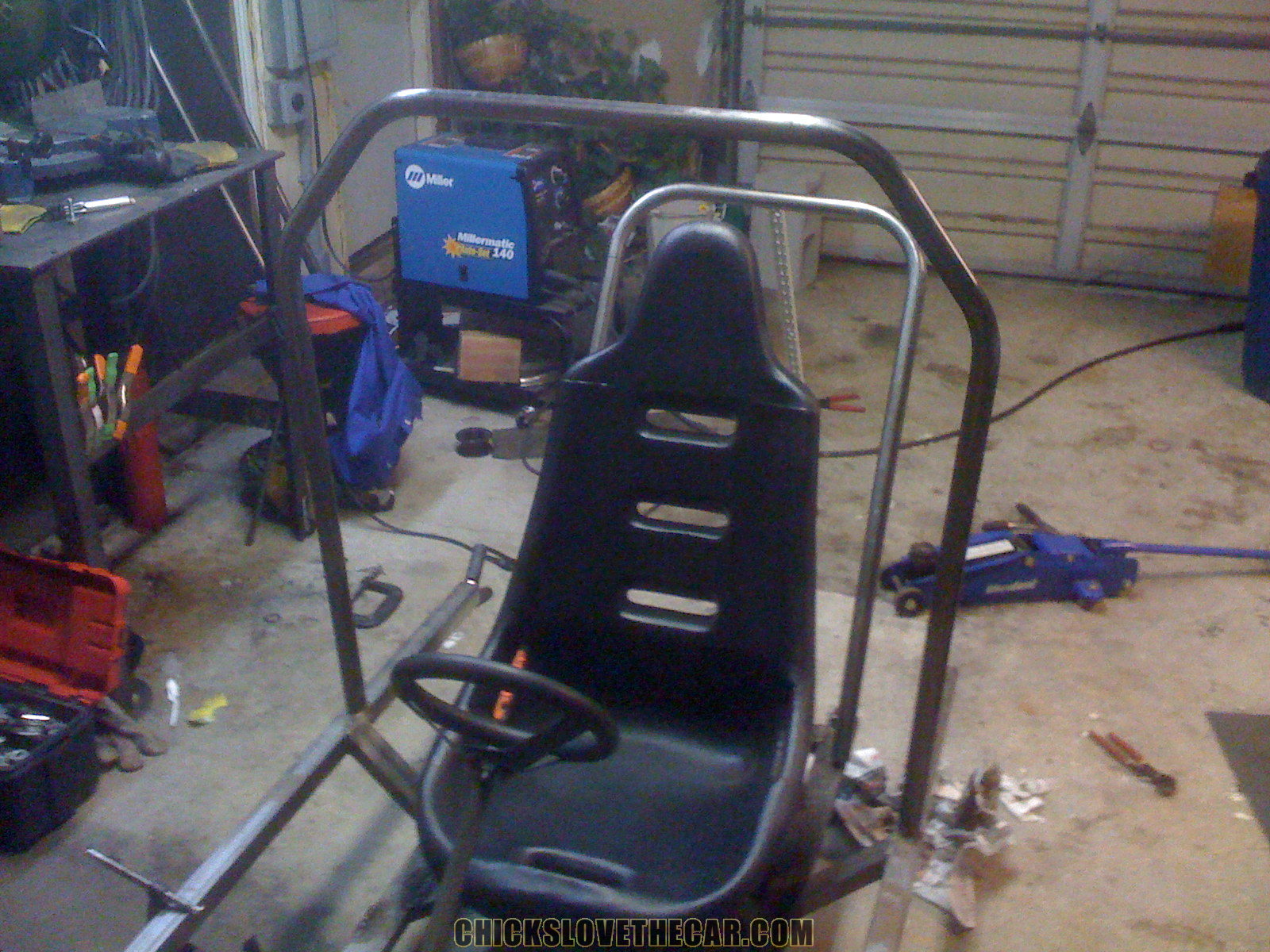

...Well i got the start of the round tubing done. I have to work on my round tubing welds but i think i'm ok to start. it's the angle of the gun i want to keep consistent. anywho....here's saturday's work... instant Jig
me notcher
set and ready to weld
