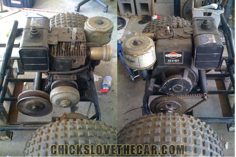

the jackshaft is the set-up that you have also on the rear of the old kart its the extra shaft that the large part of your clutch/torque converter is connected to.
Post #74548
Posted 4/16/2009 12:40:54 PM
yep...i knew what the jackshaft was....i thought you had some trick to increase the torque...

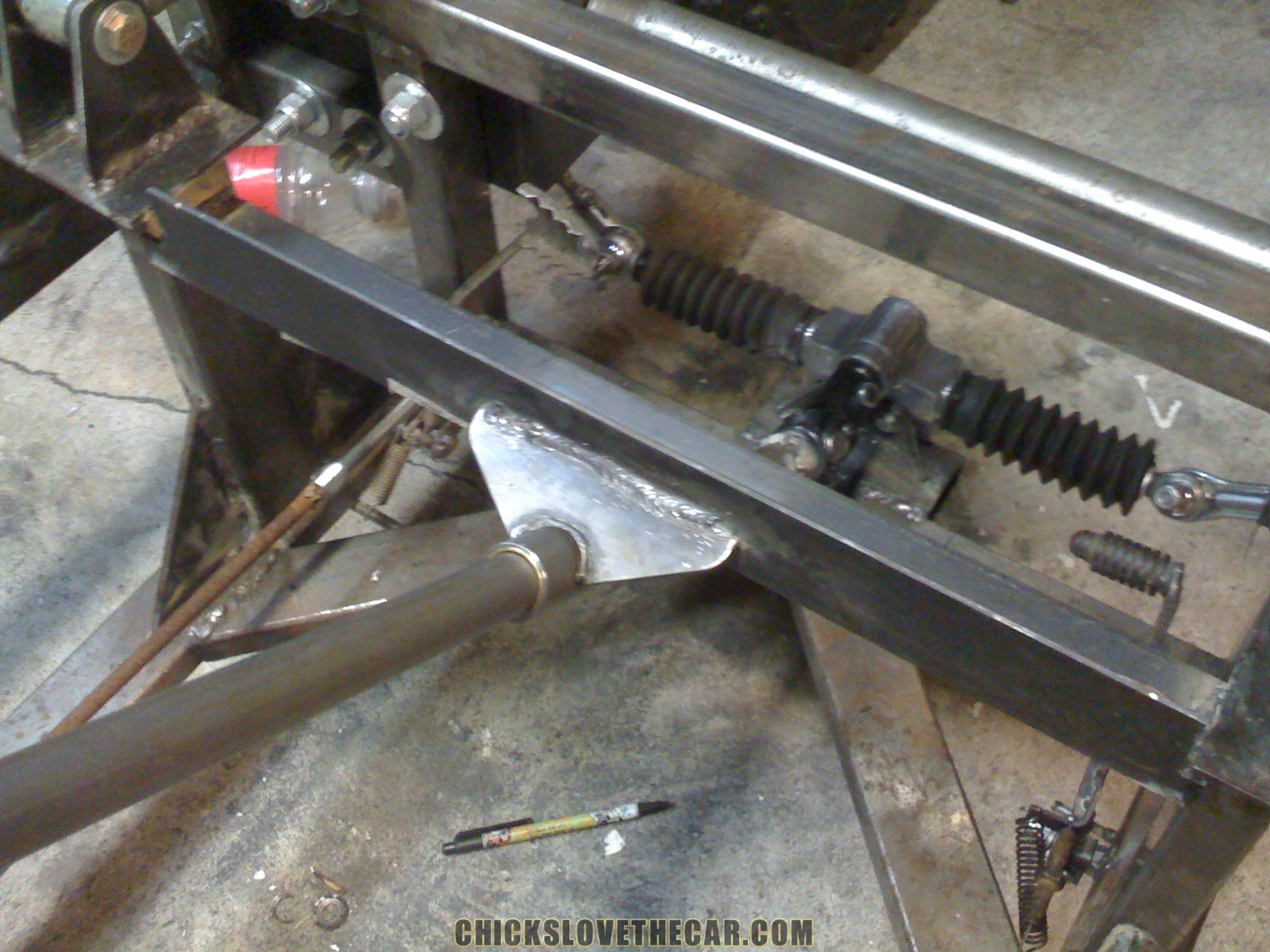

Anyway i ran into my first real design snag...what's wrong with this picture?
in a nut shell....the way this is attached to the left and right rods (bottom of the rods) a left turn makes the wheels go right and a right turn goes left. Oops.
the rod brackets closest to the R&P have to be positioned on the TOP of the rod and not down.
 like this...
THANK GOD I only tacked welded and didn't finish the welds....Fixing tonight
Post #74557
Posted 4/16/2009 1:59:25 PM
Ha Ha I all most did the same thing, in the same spot

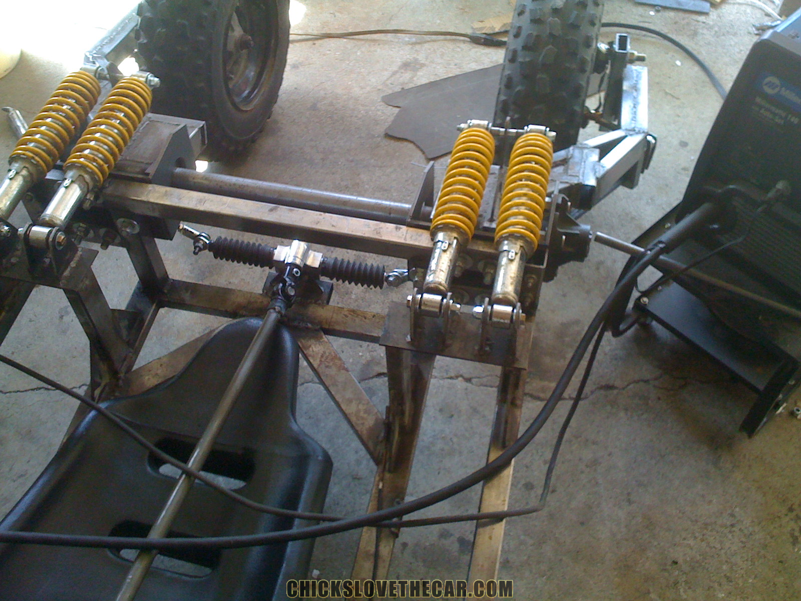

Posted 4/19/2009 10:03:58 PM
after fixing the steering issue, this weekend I worked on securing the temorary go Kart rear and complete my steering setup.

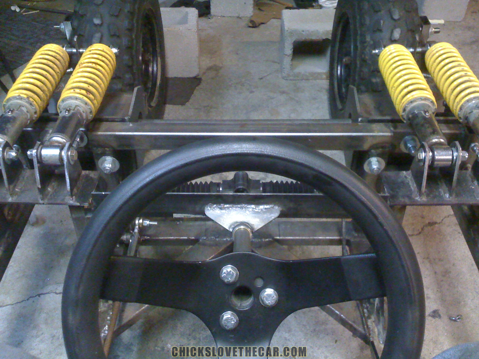

Posted 4/19/2009 10:23:50 PM
Ok so I have the steering linkage done, brakes, gas, seat, installed new drive belt. Next, steering mount.
When i saw this mounted I realized this will be my little dashboard.
Centered and welded on

Posted 4/19/2009 10:32:42 PM
from the drivers seat (the only seat! )
Post #74585
