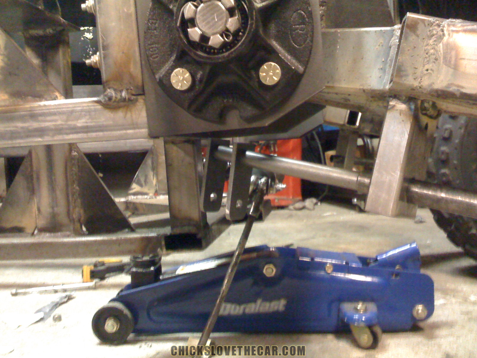

So i'm finding that I couldn't make the brackets the way i wanted...I just LOVE the way T's turning brackets look...I have to make mine much smaller as my steering controls are different: Remember that my front wheel hubs are off of a Yamaha Blaster Quad...so the steering "knuckle" or "lever" is positioned differently from a typical go kart.
My wood arms were to small so I went for more length. using scrap metal - coming in very handy cause i haven't bought any steel for a long time. Just alot of grinding cleanup. here's the beginning of my steering -
Left and Right Sides
Hard as heck to get under there with the MIG gun. I can't wait to see how I'll do with welding the brackets (next Post) onto the rods...the gun can barely fit in between the small plates...maybe I'll just do the outsides then? we'll see.

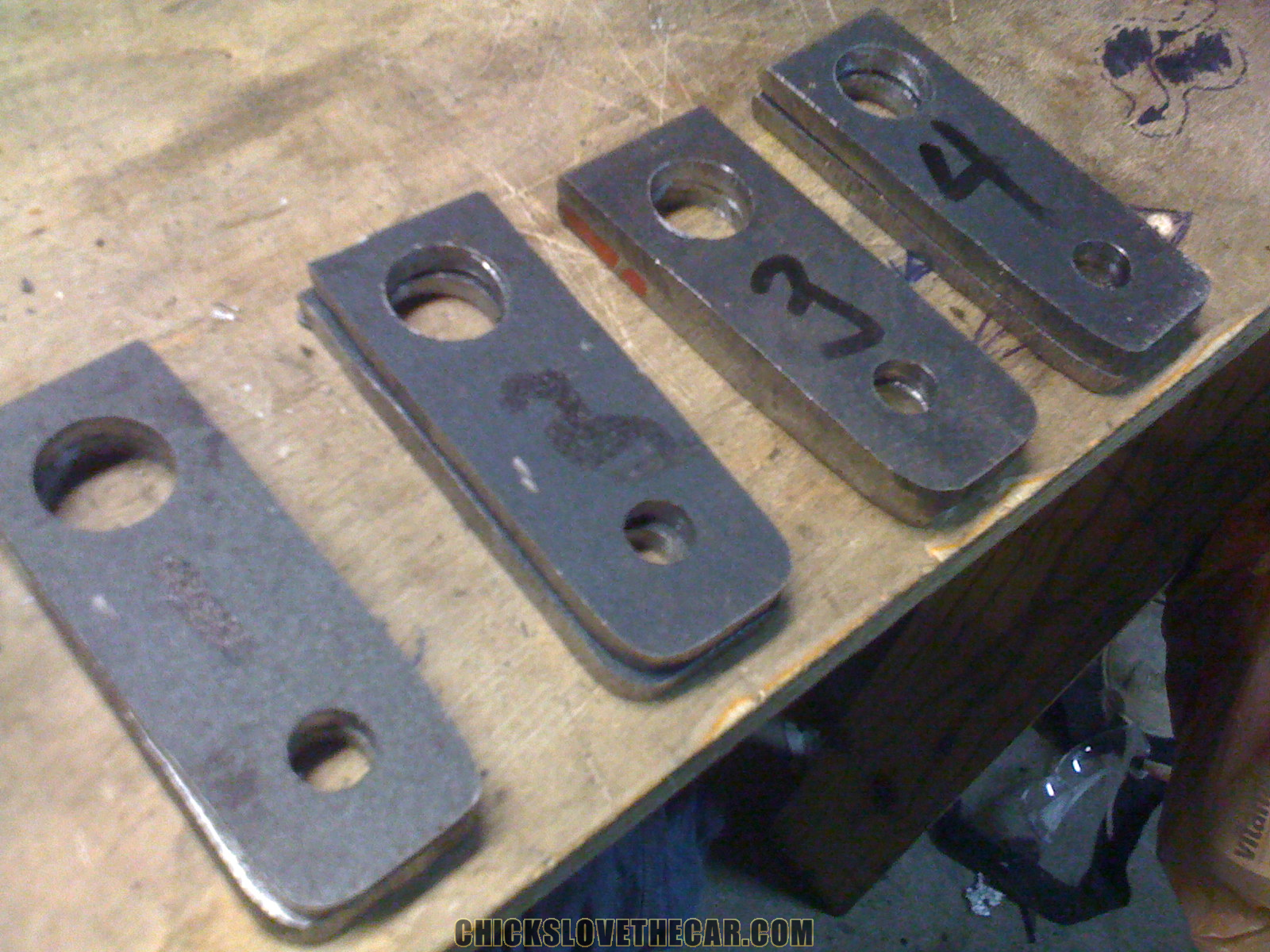

Brackets...cut and drilled from one piece of scrap metal. took about an hour to just cut these pieces and grind...Sheesh. Ok where's the Plasma Cutter?

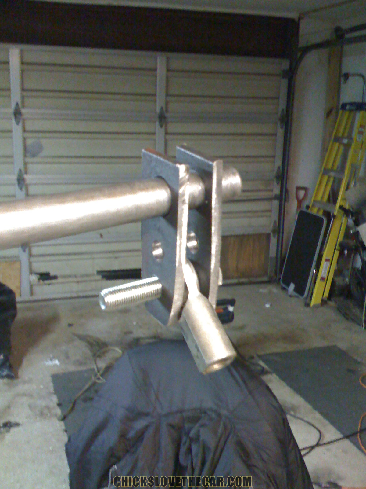

This will be the idea...I think I'm going to have problems because the rod end on my turning arm and the Wheel hub turning mount don't line up straight...because of how everything is positioned (R&P assembly, vehicle arms) my turning rods come underneath the arms and out on an ANGLE. I have to make some kind of connection that is bent to compensate for not being lined up. I THINK the original has a bent steering connector for that same reason. I'm gonna try my best.

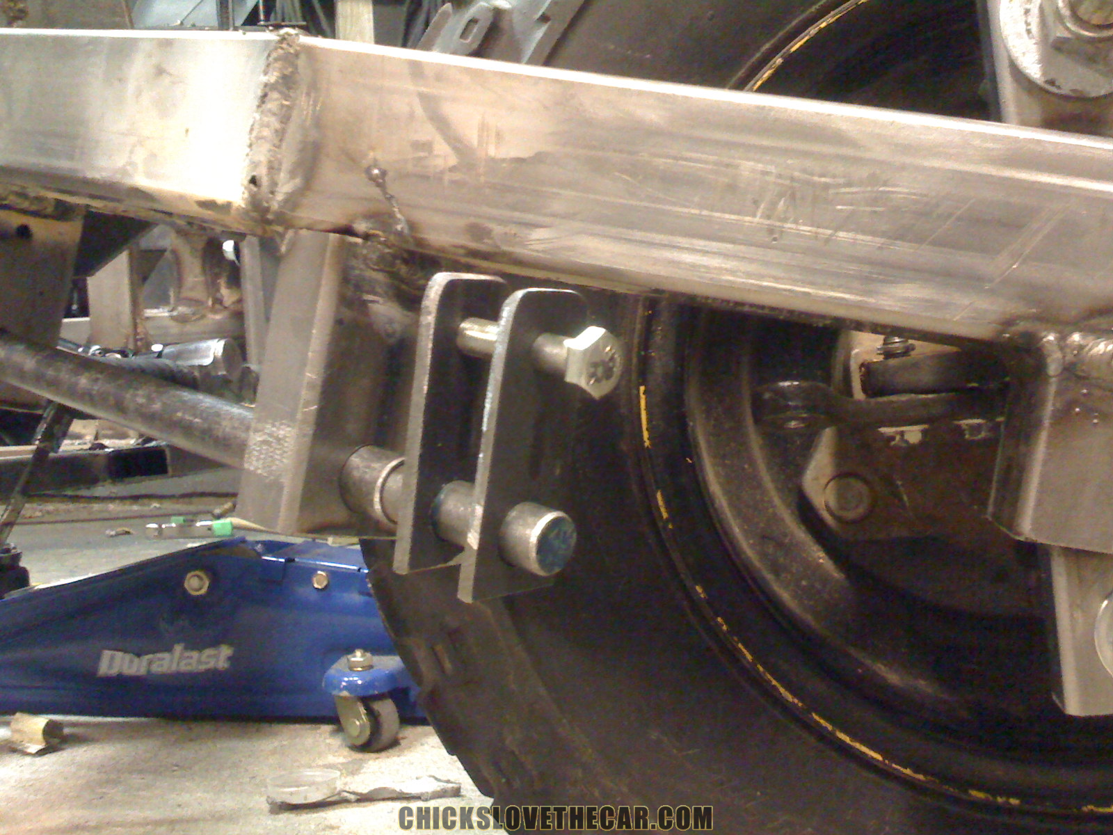

While waiting for my joints to come in last night I started to shape my brackets more - cause T's look so frikin awesome to me. Again, they're kinda small so I didn't want to shave em down to much so as to weaken them.
I'm learning so much on this site. TMan layed out his brackets and I'm basically doing the same thing...just a tad smaller. I then went to see how the heck I was going to weld a support piece of tubing in between these brackets. The welding gun can barely fit in between, i thought...how am I going to weld that? Then I looked again at T's brackets and then Heard a voice say "Duh". Dril another hole that's the size (slightly larger) than the tubing and weld at the top of the hole. Oh...Duh. Sometimes I feel pretty stupid but then am happy when I put 2 and 2 together.

Here's the Brackets fitted on a steering rod. The center hole on the brackets were drilled and the Joint in the picture is from one of the tie rods from the quad. The Chromolly ends are coming in today.

Wouldn't you know it. as I posted that the UPS guy brought me these.
yay!
