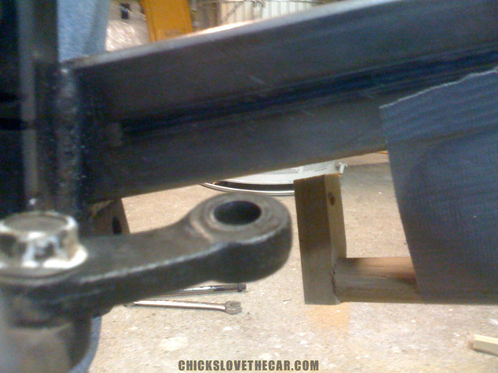

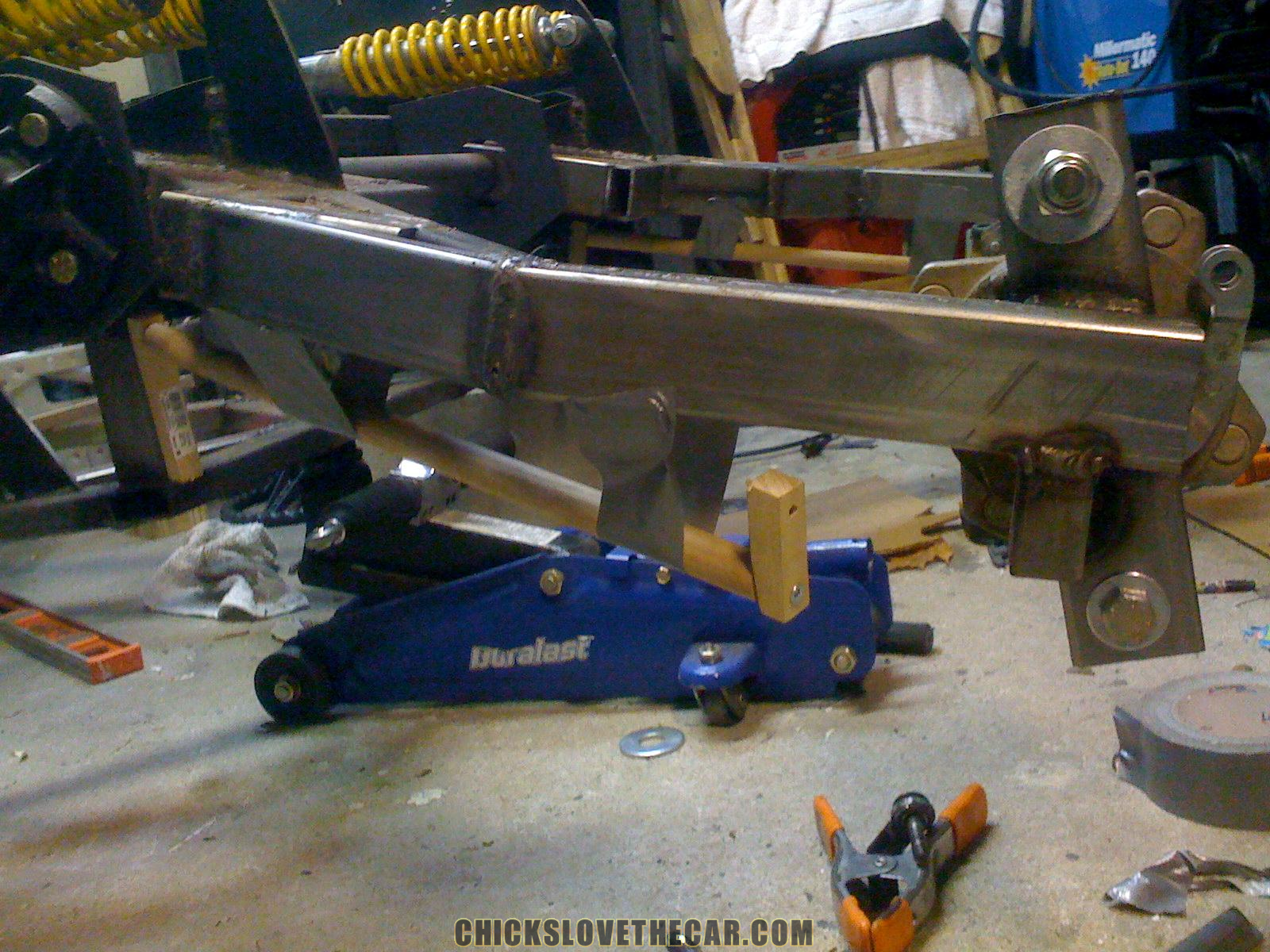

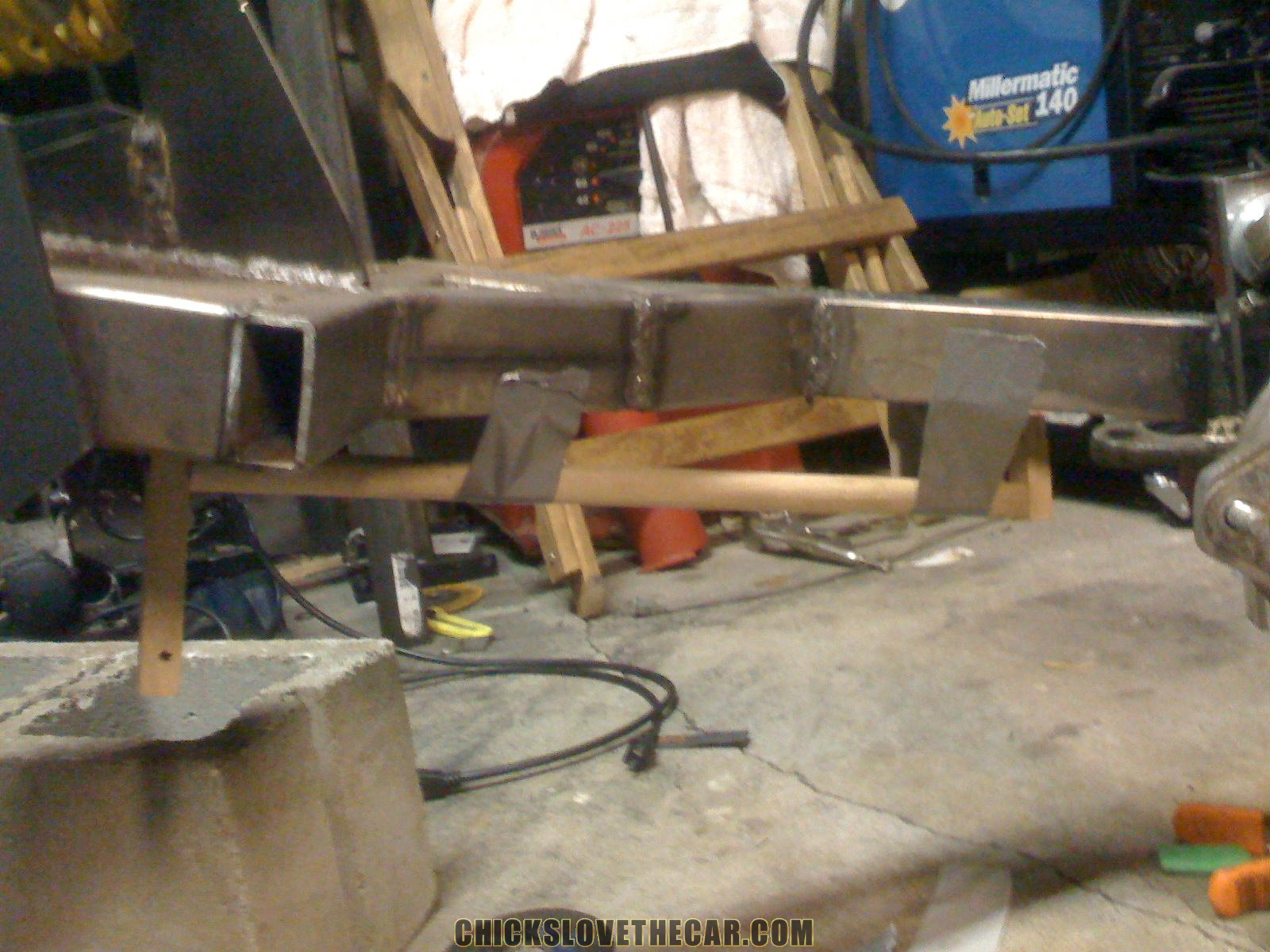

I finished the welds on the arm bracing and it's now onto steering. I'm Using a combination of shaggy's great drawing for a basic steering solution (earlier in this thread) and a rack and pinion assembly. here's the wood mockup of the steering hardware and their positioning on the front arms...
I'm going to try and make the front steering bracket (closest to the wheel hub) look like the original steering bracket.
a shot of the steering arms in relation to the R&P assembly (R&P will be mounted higher)

more..

This is where the front steering bracket will mount to the wheel hubs steering arm. I'll be using ball joints to connect everything....right? I will need some play in them to compensate for bouncing and movement....right? I haven't looked thoroughly yet but all kinds of ball joints are out there...any suggestions?

Hey Conrad, that's looking pretty strong. Great job and glad to see you posting. I'm not sure about the ball joints? I might suggest to consider a heim joint like on the end of your R&P. They have a great selection at Orchards Hardware. They have male and female fittings and right and left handed threads. They give you a little flexibility when things don't line up exactly or when the suspension is articulating (moving)  hehehe I like using that word......
I might suggest that you consider using a sliding joint along the control arm for when the main steering shaft needs to lengthen or shorten. Email me and I'll let you know where to get some of those parts.....
Before you tie in those steering arms you want to consider the Ackerman angle of the front steering. That refers to the front wheels turning at different rates for turning a corner. I could show you how that applies to your vehcle if you like....

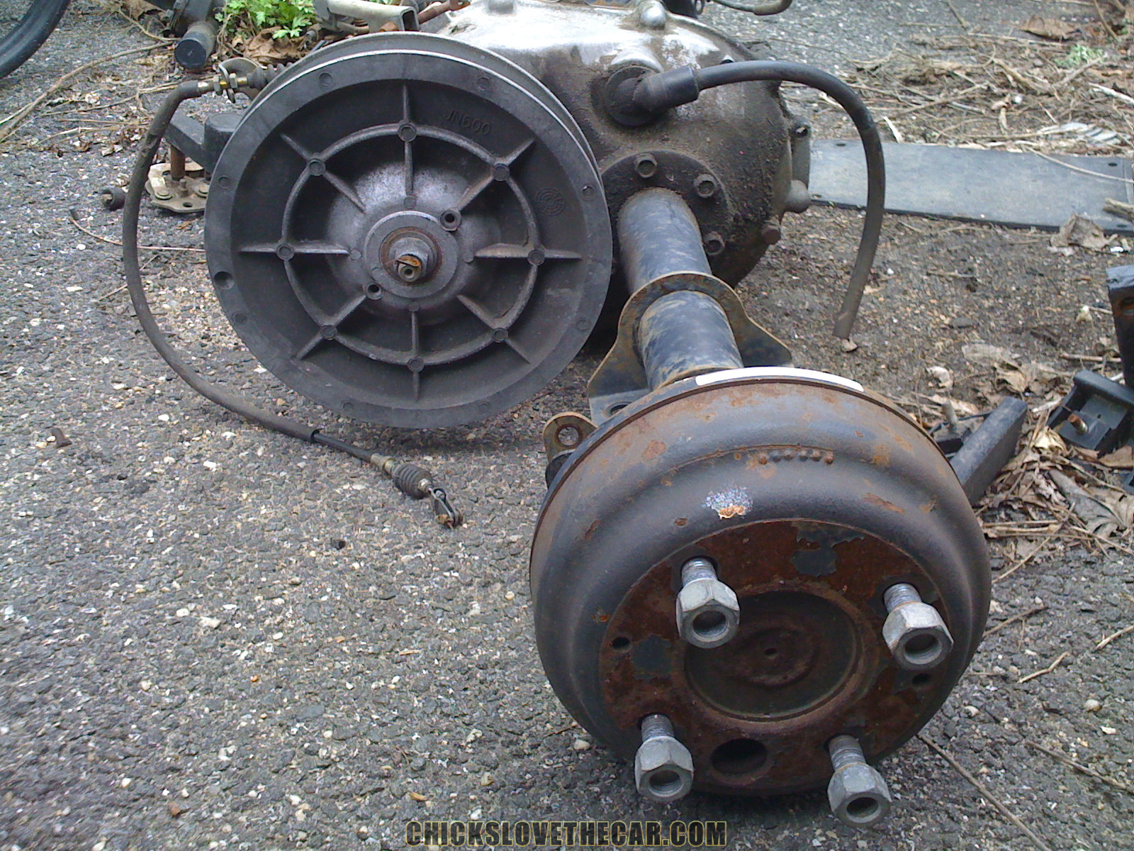

Ok well it seems that I've figured out my reverse dilema. I was initially going to try and figure a way to incorporate some kind of tranny onto the quad/ATV rear i wanted to use. that was turning out kinda hard for me so I opted to have no reverse. and one day Shagg mentioned finding a golf cart rear...at the time I looked online and there were a couple out there but I wanted to see one first hand. So now that I found that Golf Cart Dealer/service and sales shop RIGHT DOWN THE STREET from my office, I am going to nix the quad rear and fabricate a new rear for the engine and this....
Yep. A Yamaha made axle and brakes with forward and reverse tranny and the cables i need for everything.
Here's a shot of the wheel hub...I'll need to figure out if i have to replace these hubs to fit the rdually rim setup I'm using.

hay conrad that rear axle lookes great, you could leave the belt sprocket on it and then all you would have to do is get the driver part of a centrifical clutch, the right size of V-belt and you'll have power and speed...look at this page ..... http://www.gokartsupply.com/identify.htm   This page gives you a good idea on how these things work...there amazing..there are other types that use weights and generally have sprockets, I've heard that those are harder to work with to get speed and power....so you might want to stick with a belt clutch.
also this  http://www.gokartsupply.com/comet.htm
