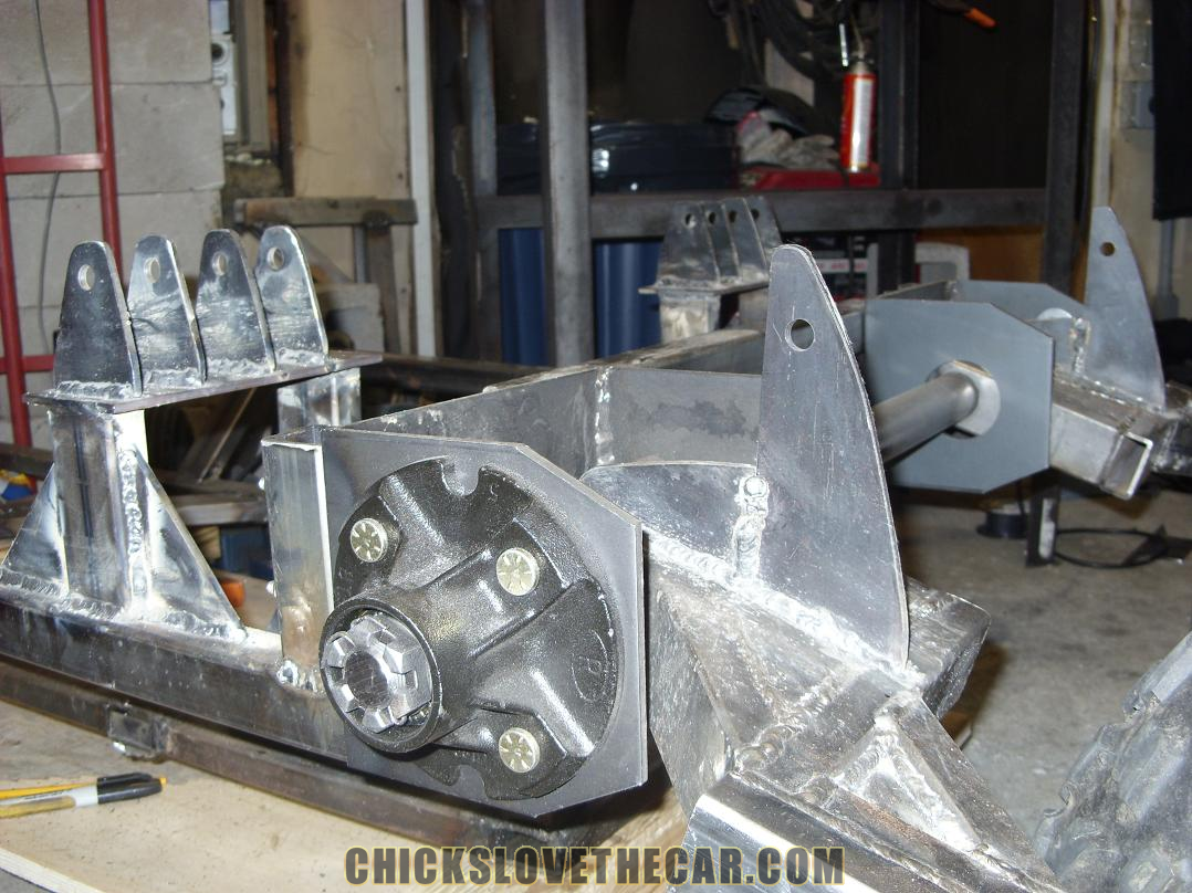

Cutting brackets...
close up
The cut off blades cut very good, but one and a half bracket eats one wheel.  Good thing they're cheap! Should have them cut and drilled by dinner time.

On to the shocks
so here are the brackes I cut last night.
Turns out I will use 2 plates on the cabin side of the shock instead of 3. Here's that layed out

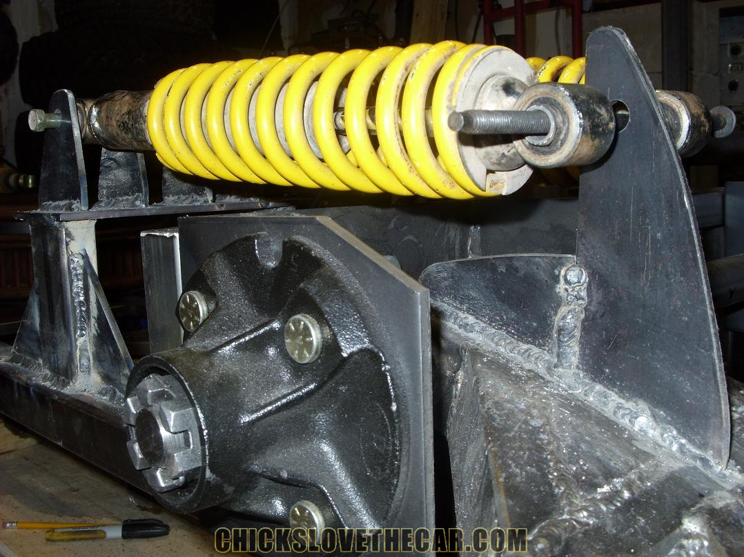

Posted 9/6/2008 5:17:13 PM
Tacked to fit.
The front bracket on the arm is backed up by another plate.
Post #71775
Posted 9/6/2008 11:13:59 PM
Fully welded....had a little trouble with the vertical welding..not very pretty, but will hold...practice practice practice.
