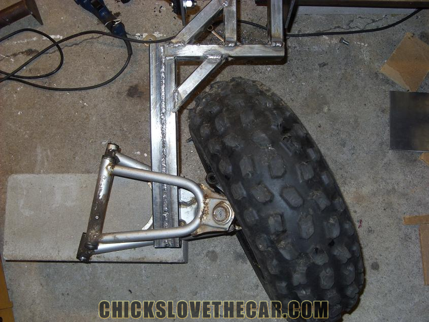

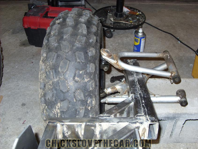

So this week I'm working on a game plan for attaching the Blaster's A-arms to mini-me's arms. Again, I'm using everything I have currently and am not trying to buy anything. Some pics
The distance from rim to control arm is 3 3/4". just enough to clear when turning.

OMG, i was about to say something along the lines of "why dont you just weld a straight rod out from the arm and connect the tire to it?"
DUH! YOU NEED TO STEER!!! gah i feel smart lol.

The lower A arm looks like they'll bolt on nicely using the shock brackets. I'll have to make something for the top arms.

You could just weld the upper arm on, by bolting the lower on you'll still be able to remove the hub and spinde to service it with out takining the upper off

I did think of that, however if i want to replace ball joint's i'd have to cut them off.
Still debating.
