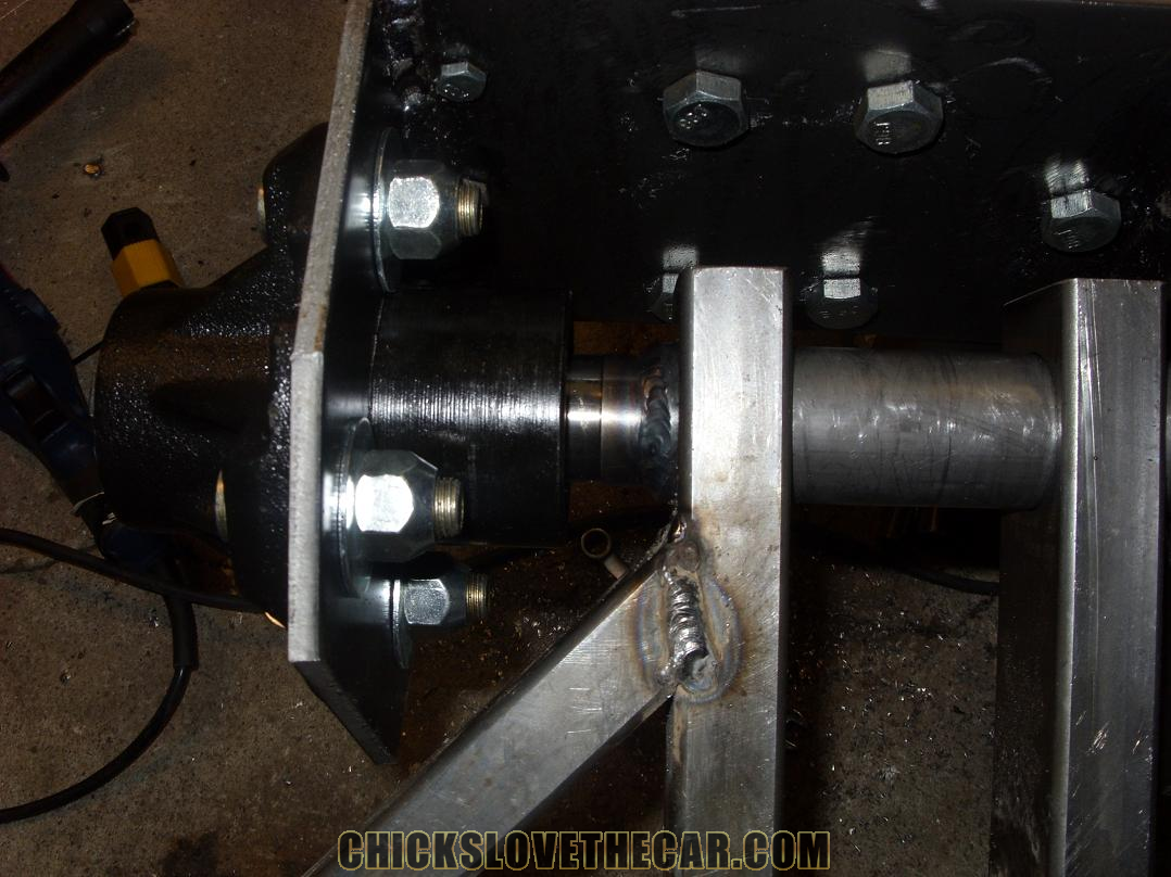

well i went with bolting the plates on...
Used lock nuts, bolt's are half inch. 4 bolts on the ends are smaller - i didn't want to put 2 large holes and weaken the 1" square tubes on the ends). I think this should hold well.

I can't even begin to tell you how impressed I am....  WOW!!!  Can I place my order now...?
