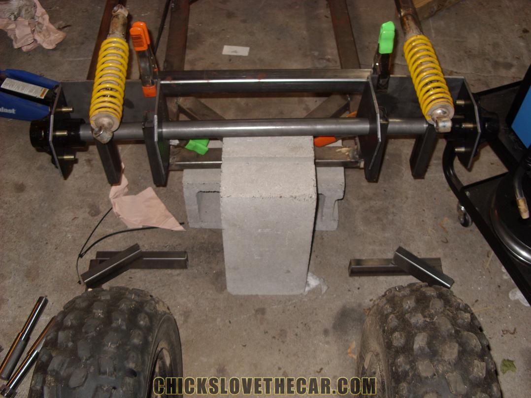

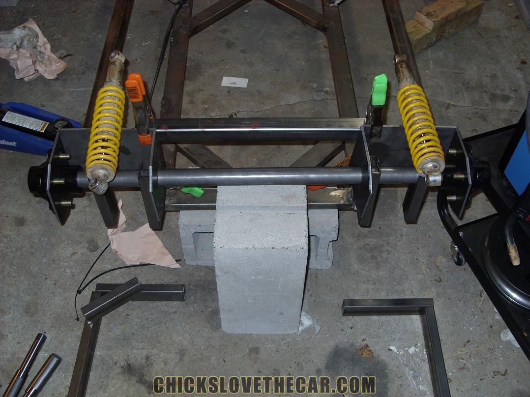

here's how the shocks will look.
sizing up the front.
So tomorrow (or today in my time), i will beginc clean up of my work area and prep for fitting and welding this weekend.
goodnight!

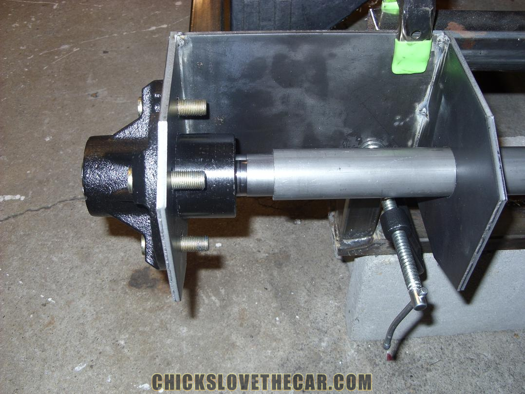

Posted 7/31/2008 9:25:02 AM
the trailer axle is actually just a 1 1/2" round tube I stuck the hubs on for mock purposes only....i bought the hubs separately and intend to weld the round tube to two 1" stub axles <- those axles are made to fit the hubs.

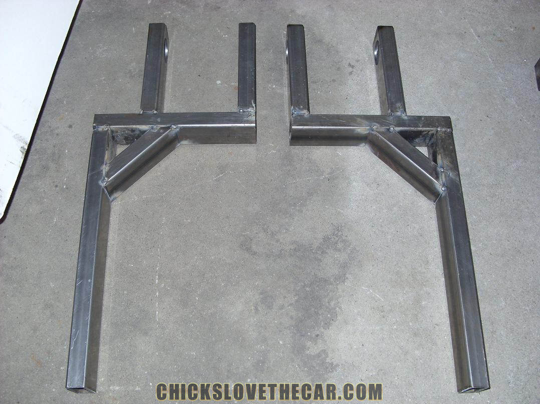

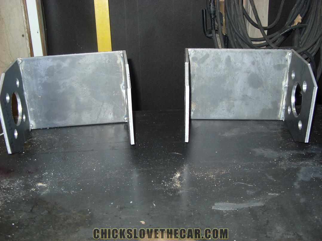

Posted 8/2/2008 12:07:07 AM
Yes....and thanks guys for the encouragement.
started tack welding the front arms and plates. good thing because i had to adjust the arms later.
here's how the arms looked at first
and the plates
Post #70961
Posted 8/2/2008 12:13:15 AM
then, right out of a chapter of BWD's Overbuilding Bible, I beefed up the front arms. I remember a friend telling me the arms have to be very strong. so for my gokart on steroids...i think this should do.

Posted 8/2/2008 12:15:54 AM
if you look at the arms in the previous picture, on each arm the top 2 forks that the axle goes through are about 6 - 7 inches apart - that's what i originally intended.
but when i mounted those HUGE hubs and the cut down axle stub, they both came into the plates pretty far.
The top forks are cut for the 1 1/2" tube and not the 1" axle. Yeah I could have gotten smaller huibs...but I move forward with what i have and continue on.
Post #70963
Posted 8/2/2008 12:18:13 AM
Right...tack weld just in case you have to pop a piece off and adjust. so here's the adjustment and more rienforcement.
