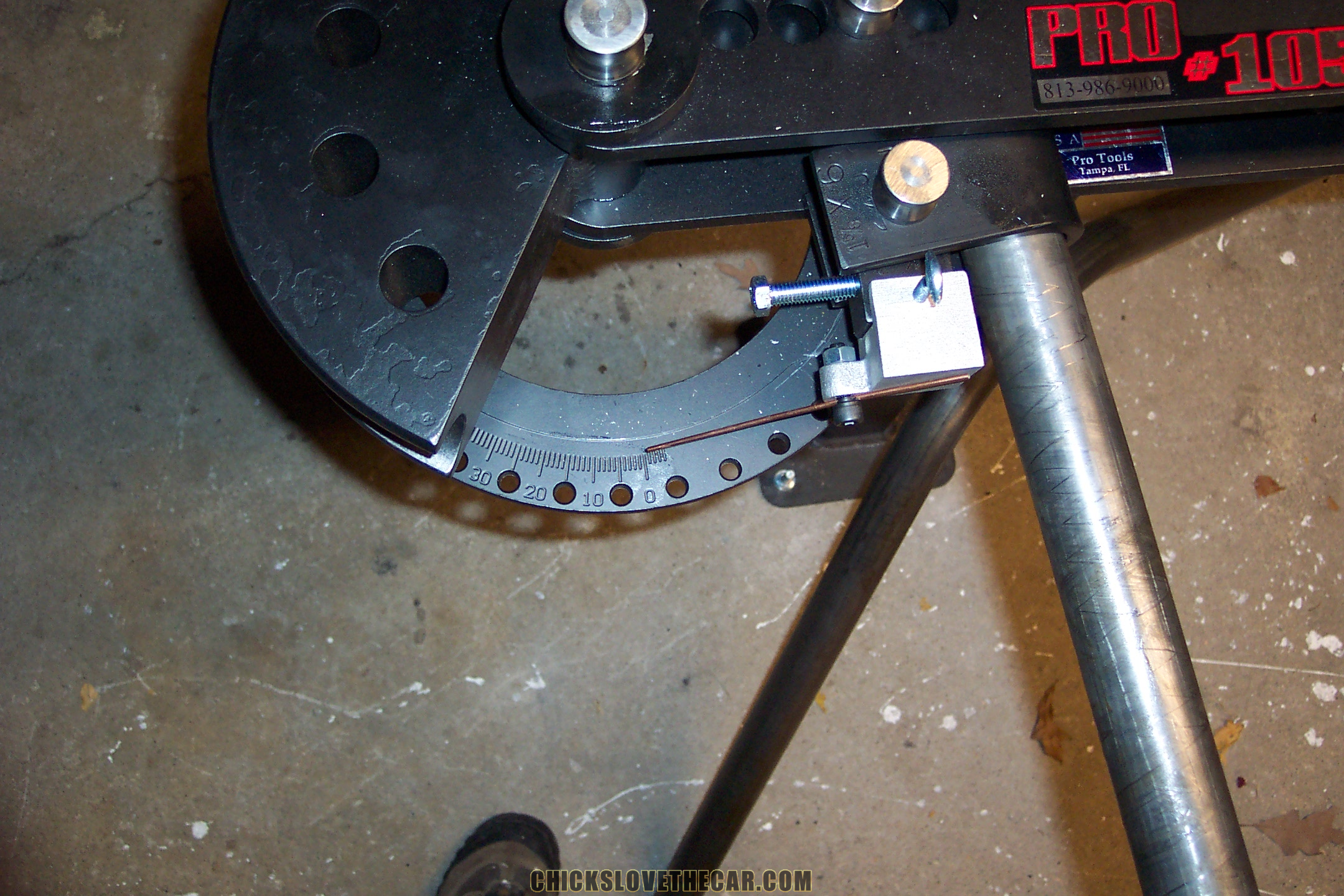

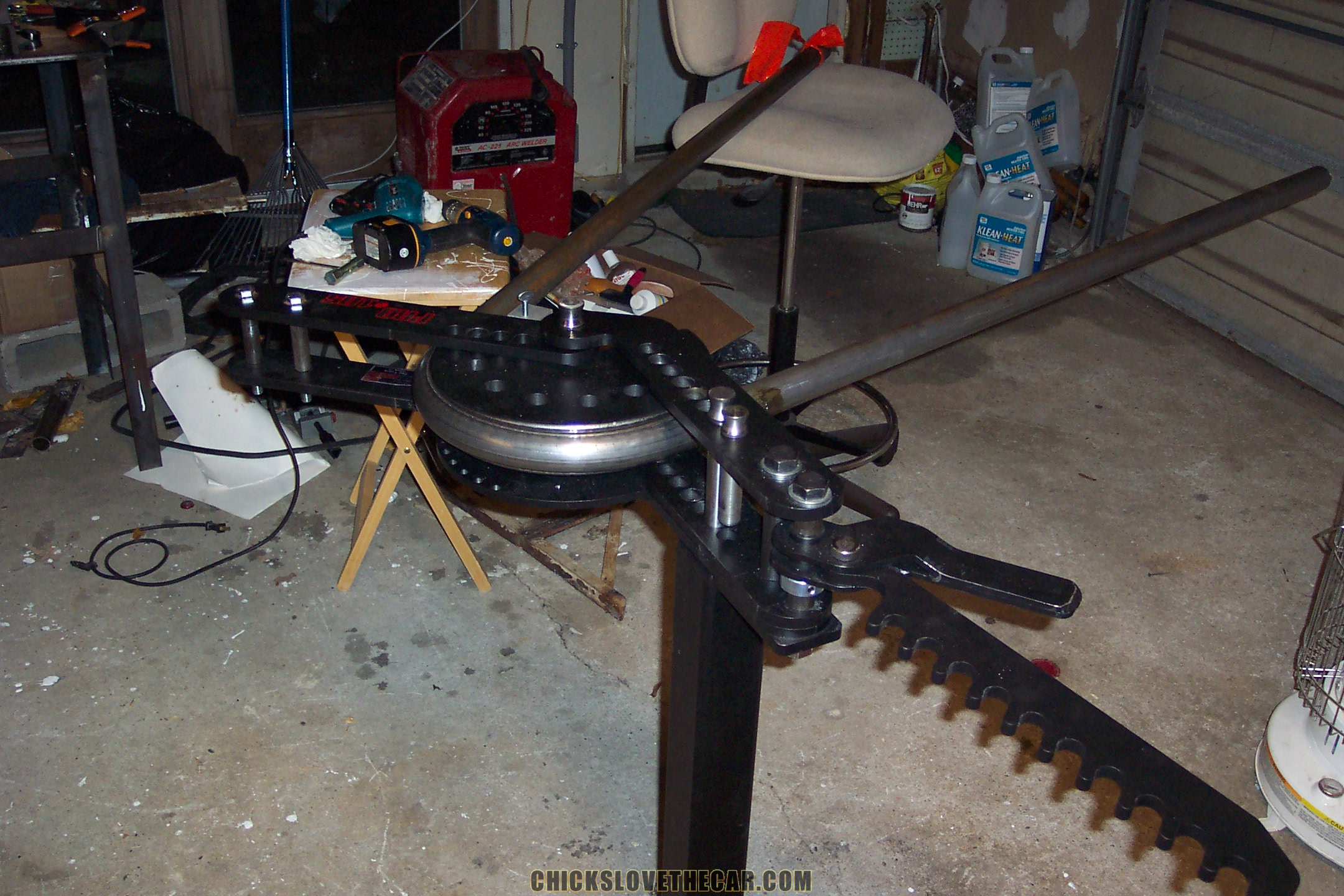

Posted 11/30/2007 12:26:54 PM
Got my bender setup.  here are some pics.  A great tool that I will probably use only for this project, but undoubtably an essential piece to have. It took me about 3 or 4 min to bend the 160 degree bends and about 1 min to do the 90 degree bend. Good thing there won't be too many 160 and over bends. Although it takes some strong pulling, this was surprisingly easy to do.  The Degree ring is very cool in that my angles can be matched with the drawings and be exactly the same. I'm excited and ready for more testing and practicing (ouch....21 feet of the DOM was 130 bucks! the good news is the more i order in abundance the cheaper it gets).

Posted 11/30/2007 12:29:45 PM
Here are some finished practice bends. As i said, the 90 was quick and easy to do. the 160 took a few more minutes. I'm very happy with the way the bender works and my ablity to work it.

Posted 11/30/2007 9:09:44 PM
Posts: 5,397, Visits: 4,897
Hey the bends look very good. I know the hardest thing is to get both sides exactly the same but that is critical to the final performance ot the vehicle.
I cannot stress the necessity of building your vehicle on a strong jig. The jig needs to be strong enough to prevent the frame from flexing. Then the tubing needs to be welded to the jig. The creation of the jig will help to keep everything square and gives you a reference to measure off of. Cut all the sides and the ends of the jig square and measure from corner to corner. Measurements should not be taken off the floor of the garage but from reference points on the jig. I think mine was 8" "I' beams and then we used casters so we could move it around the shop.
The hardest part is to throw away a piece because it didn't match the other side that's why you should bend the longest pieces first and don't use your DOM for practice its just too expensive. Sorry these are just suggestions I'll post some pictures of my jig. And may the force be with you....BWD
