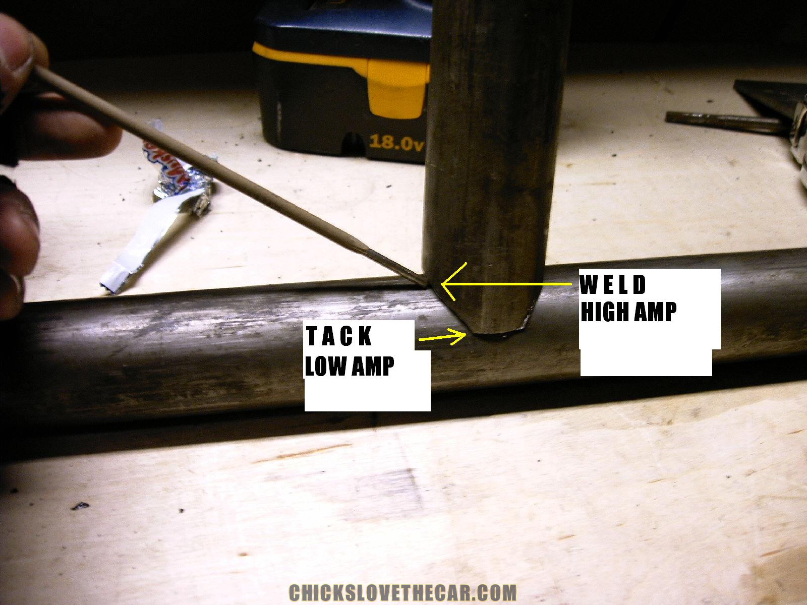

thanks Shagg...hope all is well with you and your new wife. Startin to get in the 40's round these parts but the welding practice keeps me warm. Hope you too are tinkering with your projects. Yes the weld amprage was high. I spoke to a guy at the local weld shop about the need for good penetration. The tubing I'm using is .095 wall thickness and when notched the edges thin out. This is where I burnt the most holes. I'm thinking I should tack those areas and start on the thicker part of the tube.
the higher amprage should be high enough to penetrate well but not burn through. I still have to experiment with amps cause when I've tried to go to low the tack breaks off pretty easily. normal? i guess tacks are not intended to be super solid, just enough to hold for main welding.  just typing this now is making want to stop typing and get to it. so i'll do that.

are you grinding a bevel around the end of the pipe your welding? That helps ensure you get good penetration and that may help with the trouble your having on  the thin edges of your notches.

bean...do you mean bevel the end of the tube so it lies more flush on the bottom piece? maybe grinding those thin sharp pieces down? sounds good. to bad i'm outta tube scraps...gotta get more Monday.

Yea, just grind a 45deg angle around the end of your tubes.

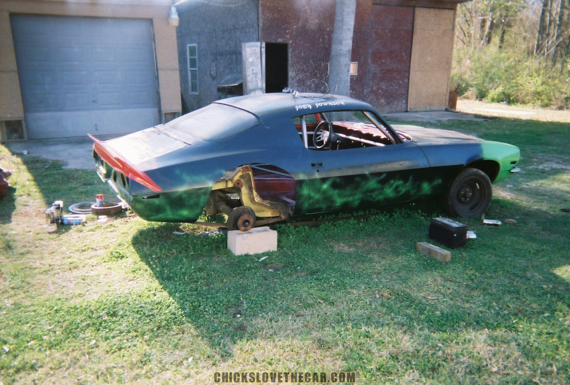

Yeah i used a stick to do all my tack welds, at the time (well now that i think of it, even to today) i couldn't weld a roll cage adequately, had to let my dad do all that, but i did do all the beveling, measuring, cutting and tack welds.  my dad just finished the welds on around for me .   Here are some pics of that car and roll cage (pointless i know, i wish i had some close ups of the welds themselves)
^ Thats my dad finishin up the welds that i tack welded in for him.
Thats the paint job on the passenger side before i finished it
The driver side finished.   And to think, i GAVE this car away

Cool pics! will continue practicing with the stick...I'm finding that the right electrodes are the key to strong bonds. When i use 6013 sticks, the tacks are easy to crack or break. When I use 6011, at the same amperage, the tack is stronger as is the weld. 6011's arent pretty and cause lots of spatter, but the welds are strong.
