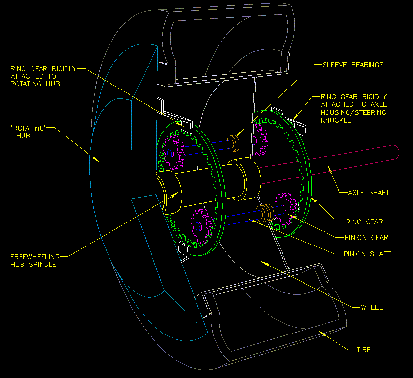

Seems like a lot of geeky engineers hang out at this site...
First of all, the weighted spinner theory: regardless of the weight inertia would cause them to rotate on acceleration or braking. I'm not really familiar with the Forever movie but it appears they use a mechanical system (supported by the previous discussion).

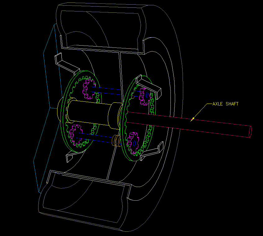

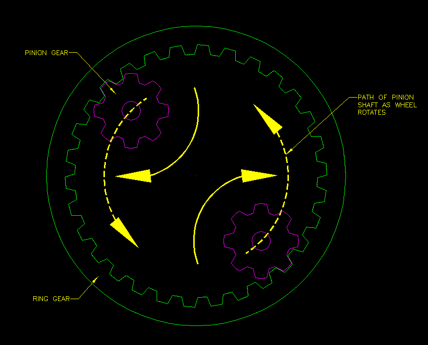

You essentially have three planes of movement here: the stationary ring gear attached to the axle housing or steering knuckle (much like your car's brake calipers), the pinion shaft that passes through the car's wheel (supported by sleeve bearings), and the ring gear attached to the 'spinning' wheel hub assembly.
The wheel rotates on the axle, the pinion gears rotate around the inboard ring gear on a shaft that passes through the wheel and held in place by sleeve bearings. The 'rotating' hub (Bat symbol) is attached to a freewheeling hub spindle. The outboard ring gear is rigidly attached to this rotating hub.
If you removed the pinion gears and shaft the Bat symbol would spin freely. However, with the pinion gears in place the inboard and outboard ring gears are 'locked' together and not free to rotate independent of each other yet the wheel and tire can still spin on the axle.
Hope this helps.
P.S. If any of my terminology is incorrect, I apologize. I'm a structural guy not a mechanical guy.

That's exactly what I meant...
Wow, that's really cool. nice renderings there too. It would be cool to play around with the gear ratios to make it spin backwards or slowly forwards. Okay, now where is my box of ring gears??? "Honey, I'll be outside by the mini-van!"

VMan, that CAD drawing looks exactly like what was explained to me. It's one of those things that is difficult as hell to explain and even draw but I'm sure once you see it..."Smack" on the forehead. The other thing is that not only does the bat logo remain perfectly straight but it of course needed neon lighting and wiring coming through the rim and up to the front! More head scratching...
