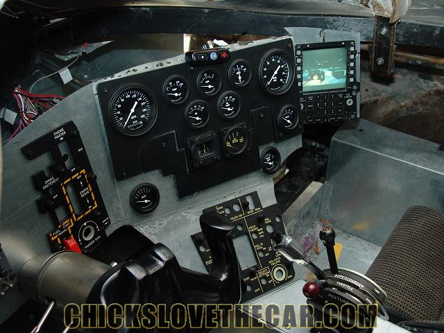

I totally agree with you.    Its hard for me to explain what i am going to say but I'll try.
In My GMC that i just got running, the steering column is out of an 86 Silverado, the GMC is an 89, the shifter rod attachment on an 86 is on the right of the column, the shifter on an 88 thru 94 is on the right, this caused my shift patturn to be reversed.     So now Park is where low 1 is on the column, and low 1 is my "crank" position where Park is on the colum.   The shifter on the column free floats, so there are no designated park positions, nor reverse, or drive positions, its simply a lever on a rod that moves the "clicker" on the side of the transmission.
Now the 700R4 i have on the GMC has a positioner tab inside of the transmission, all transmissions that i have delt with (that are not fully computer controlled) have this positioner inside of it.   This keeps you from NOT being fully engaged in a gear, in other words, you cant be half in or half out of reverse, drive, neutral, etc.    Your either IN, or not, no inbetween.
My 72 camaro has what is known as the "horse shoe shifter" by Hurst, it has a positioner on the shifter (just like B&M makes) as well as a positioner built into the TH350 Transmission in the car.   These two positioners NEED to be alighned or it can cause you to incorrectly select a gear (plus it makes it more of a hassle to go from one gear to the next.)   The cable on my Camaro broke one time and i had to pull all that apart just to put the new cable in it.   I never could get it fully aligned again, thank goodness I've decided to convert it to manual.
Thats why i thought it was weard to have a secondary shifter when they had 3 levers to choose from right there in the center console.  And as long as the person getting behind the wheel know the old "Park, Reverse, Neutral, Drive, 3,2,1" patturn, anyone could just grab the shifter and switch gears.     Also I've never messed with the aircraft shifters that are in the 89, but i believe they would be free floating without a positioner built into them, especially NOT for an automatic chevy transmission .
Just my 62¢

The simple answer is.... Most aftermarket shifters (Hurst, B&M, etc) all are done by cable.   That cable can be bought in lenghts up to like...well I don't know but I bought a 4 foot one.  Being a cable instead of rods and linkage makes it easy to place anywhere you want to.  Piece of cake...

Hey Jack is right.... On my T-Rex I have a Lokar shifter and its just cable driven so I have to feel the click of the 700R4 tranny. Every once in a while I feel the car taching out and I realize I am in second gear so I slide it forward and I feel the tranny shift into third then fourth. A couple of times I thought it was in second and I shifted into neutral and yes I have even accidentally shifted it down into reverse a time or two......It makes an expensive sounding noise....I think by using the shifter mechanism this would be eliminated but of course the shifter and tranny must be properly aligned.
Shaggy your shifter issue reminded me that prior to the current column shift pattern the pattern use to be  set up with the reverse all the way at the bottom. I remember my dad telling me they put reverse after park because children would grab the shifter and push it down into reverse. We had a 55 Buick Roadmaster that was set up that way. In the good old days it was perfectly fine to let your children crawl all around the car while the car was in motion. Those were the good old days...Cars were unsafe and we liked it that way.....my 32 cents....BWD

Hurst/Olds Lightning shifter looks almost like the orig Batmobile setup and actually works (albeit not that well). Then again if you wanted to really build a super high performance Batmobile, you could use a Lenco, that looks even more bad-ass than the original Batmobile....but they are quite expensive.

Why not use what is suspose to be there you can still hook up a cable or linkage to make it work....

Because unless you plan on making the car 4x4 with an Atlas transfer case and air lockers what will the other two levers do?
I suppose one could be made into an e-brake, but that still leaves one dummy lever.
If you go with either of the shifter mechanisms I suggested you can then simply use the aircraft assembly as a cover and add the nobs for the correct look and it will all be 100% functional.
