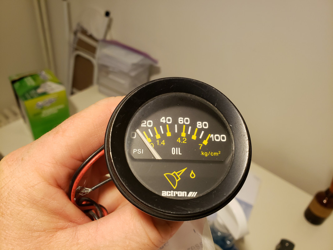

Got another gauge for the dash- not 100% but close

That collection grows quickly when you start locating all of the parts needed. You'll have a completed car in no time at this rate! I'm Jealous!

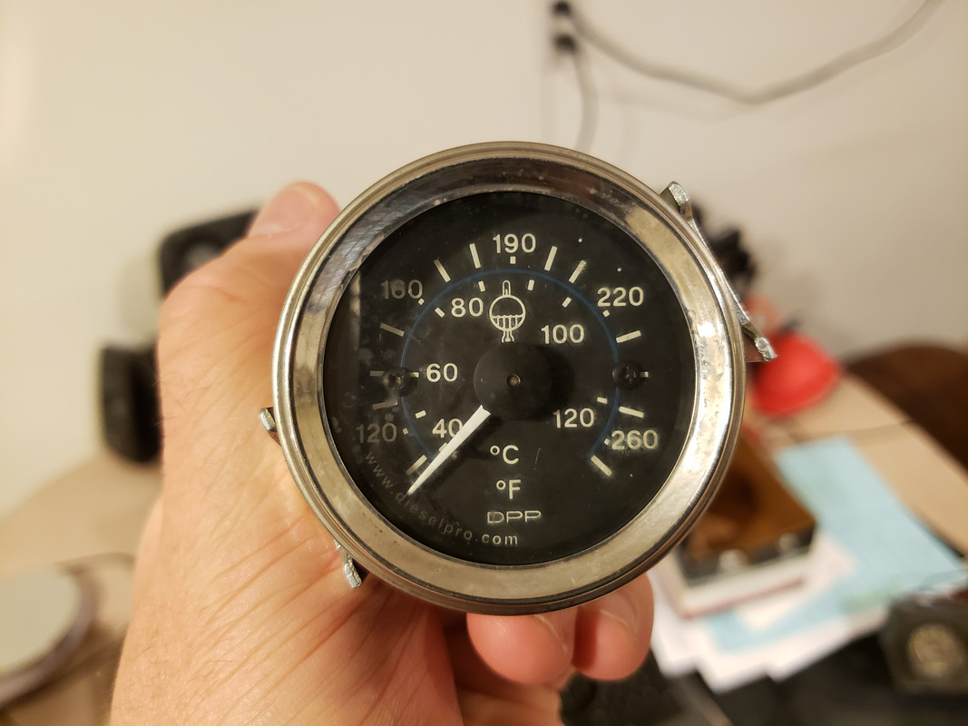

Another day, another package
An exhaust temp gauge from Westach- not 100% but closest you can find

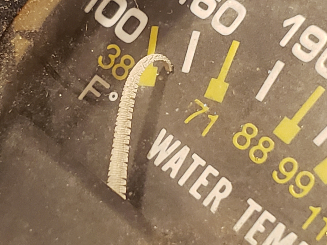

More gauges, these have warped needles
These are either identical or very very close:

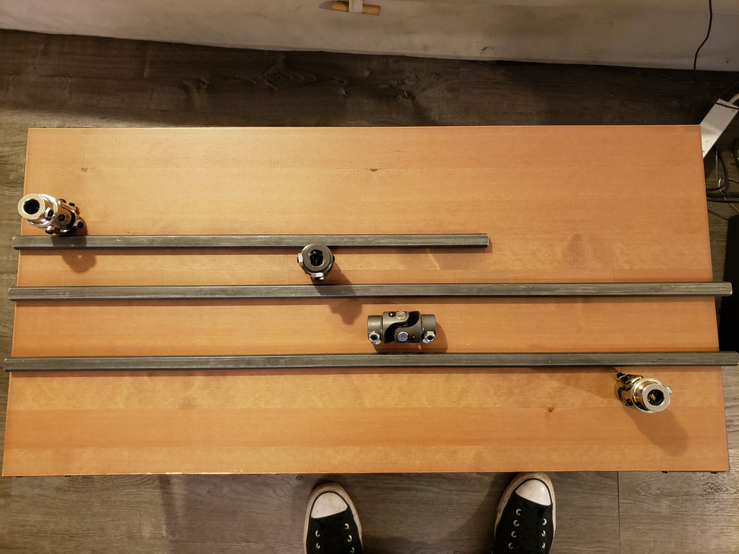

Steering stuff. Hopefully I got the correct Spline count for the Steering box and gm steering shaft. 36 and 30 spline to DD U-joints. Got 2x 35" DD steering shaft, 1x 24" DD steering shaft and 2 DD to DD 30 degree angle U-joints and three 3/4" steering shaft end links. Will buy extras just in case.

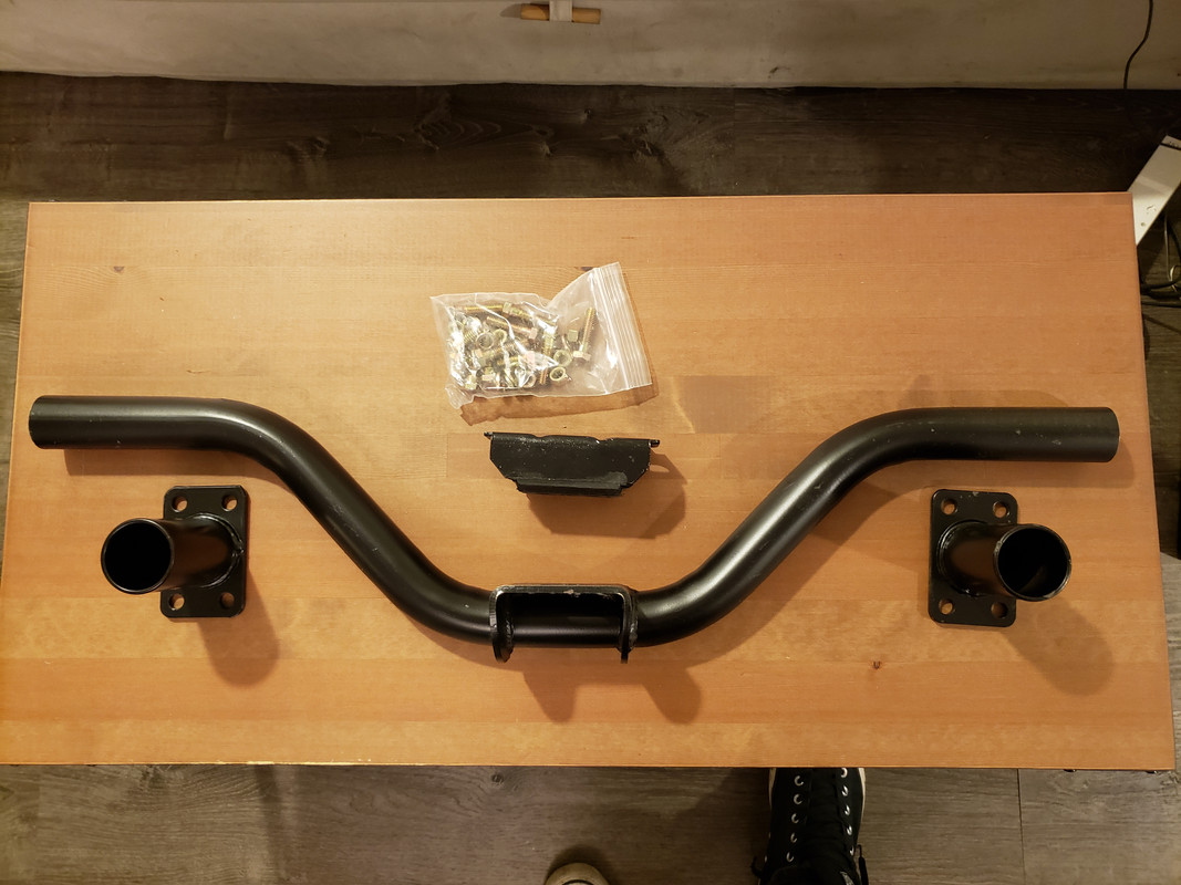

Here are the engine and transmission crossmembers from Trans-adapt. My donor is a 96 Impala SS so I have a LT1 and a 4L60E.
The engine crossmember is a SBC universal one with rubber mounts, the trans crossmember is a 6" drop one- I hope that is doable and I didn't shoot myself in the foot with that one lmao
