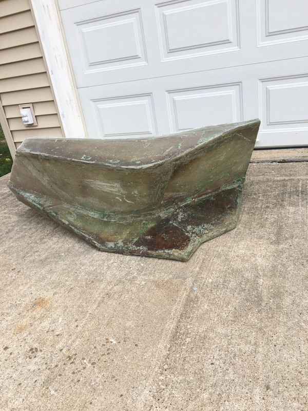

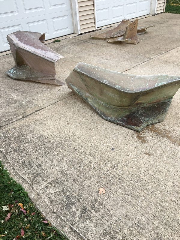

Finished the other rear side box today. The same thing as before only reversed.
And the two boxes together.....

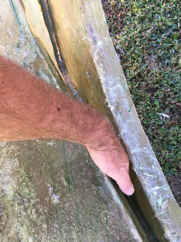

Well, now we're down to it. The space in the mold is just too narrow to get into to lay the fiberglass.
Any ideas on how to get in there to lay the fiberglass would be appreciated.
So far, my solution is to make up a batch of resin and mix in a bunch of fiberglass fibers, then pour the mixture into the mold. That was about a gallon of resin and quite a bit of fiberglass. With this amount of resin, the fiberglass will get really hot as it cures. So I'm hoping it won't melt the mold. Also, it will make the front of the box quite heavy. Any other methods would be welcome.

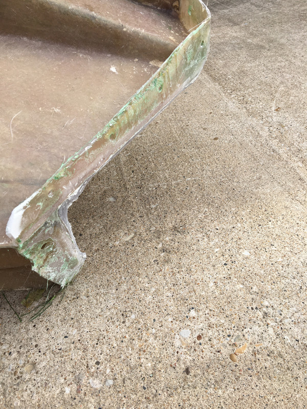

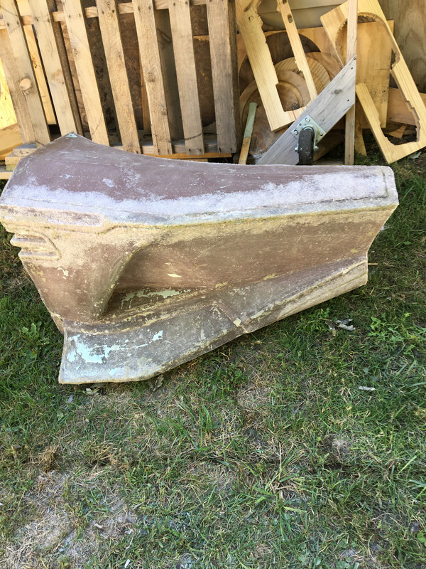

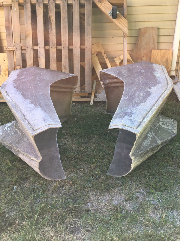

Finally got some time and a bit warmer weather to finish this front box. Today I started by cutting and grinding off the excess material past the edges of the mold.
Then I started removing the mold from the part. Looks like that area I was worried about came out fine.
This time I put on several layers of green parting film. That worked great, as most of the mold sections just lifted off the part with little effort. These pictures show the residue from that still on the part as I haven't cleaned it at all yet.
Here's the front and rear box as they would be positioned on the car.
Weather is getting bad now so I guess it's time to wrap it up for this year. I'll have to save that last box for next spring.
