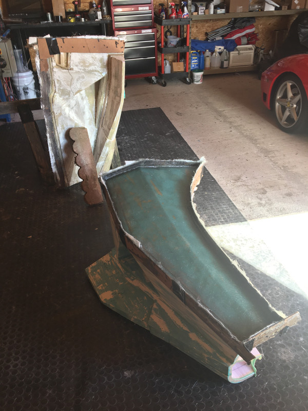

Progress report:
Weather has been pretty nice so far this October. Haven't had much time to work on the project because of family commitments, but did get a chance to start making the molds from the plugs. After a couple of days work last week and a couple more this week I managed to prep and glass the top panel of one mold and both the top and rear panel of the other one.
