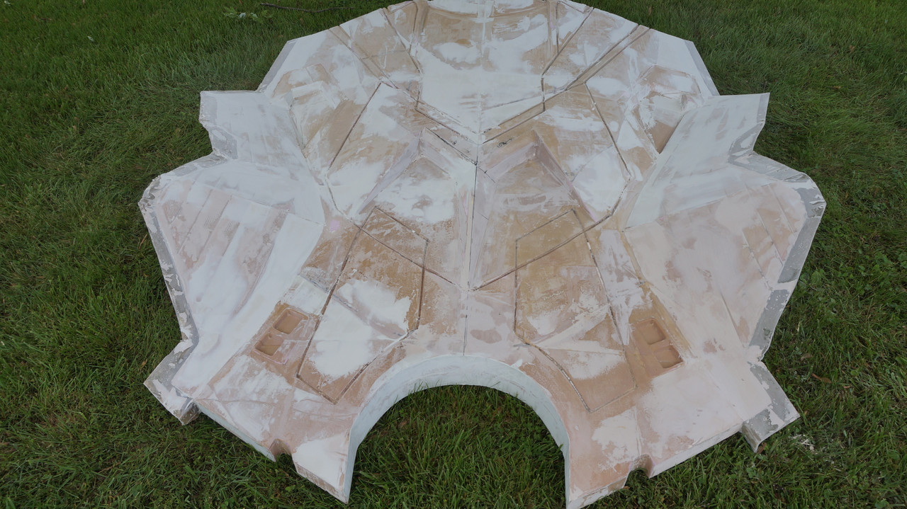

Driver side front bottom mold now complete. I know you only can see the backside of the mold from these pics but I don't want to remove the mold yet because the flanges need to line up with the next mold.
And here is a pic of the top. You can see the flanges I'm talking about extending from the side edge.
Now it's time to start the prep work on the top section pictured above. That's starting to get exciting. Thinking about doing it as one large piece but I'm just a little concerned about the helicopter lift points in the front that are pretty deep and may cause a separation problem.

My method for preparing the plug is step one, Use body filler putty to repair any large gaps or anomalies in the plug form. Step two is to use a thinner version of body filler putty to smooth out the shape. Step three is to use a finishing putty like "easy sand" to make a nice smooth, even surface. Then I can do the prep work to make a mold. That involves putting on flanges if needed, waxing everything, and putting on a separating agent.
This is the front top section with stage one and most of stage two completed. I will post again when stage three is complete.

Finally finished the body work on the front half of the main body. The procedure I used took way too much effort to produce anything close to a satisfactory result. On the rear half I have an idea for a different approach that might be quicker with less work. Worth a try.
Today I installed the flanges. Next couple of days will be applying the sealing clay, waxing, and then applying the mold separating coating. This weekend should be doing the fiberglass.
