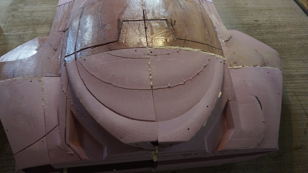

Let's see if this works. Seems the board is having some difficulties.
It's been a while working on this section because I had some mechanical problems with my router and several distractions in real life. Also, this was the most complex section so far that had a lot of tricks to getting all the compound curves and angles right.
But finally got the next section completed.
This time I was able to get the undercut on the back of the roof line that I didn't get with my last body attempt. Not sure if you can see it in this pic, but take a look.
And the underside of the ram air jet.....
The rear engine vent cutout...……..
View from the rear
One last section to mill for the main body.
btw, During the down time I did manage to carve in the decorative lines on the body so far, put a layer of protective resin on the one section you can see is a different color, and sand off milling tabs and anomalies.

My first thought was to divide it into sections like the original. Front clip, the two doors, and rear clip. But in reality I will have to divide it si the mold can be separate from the part.
