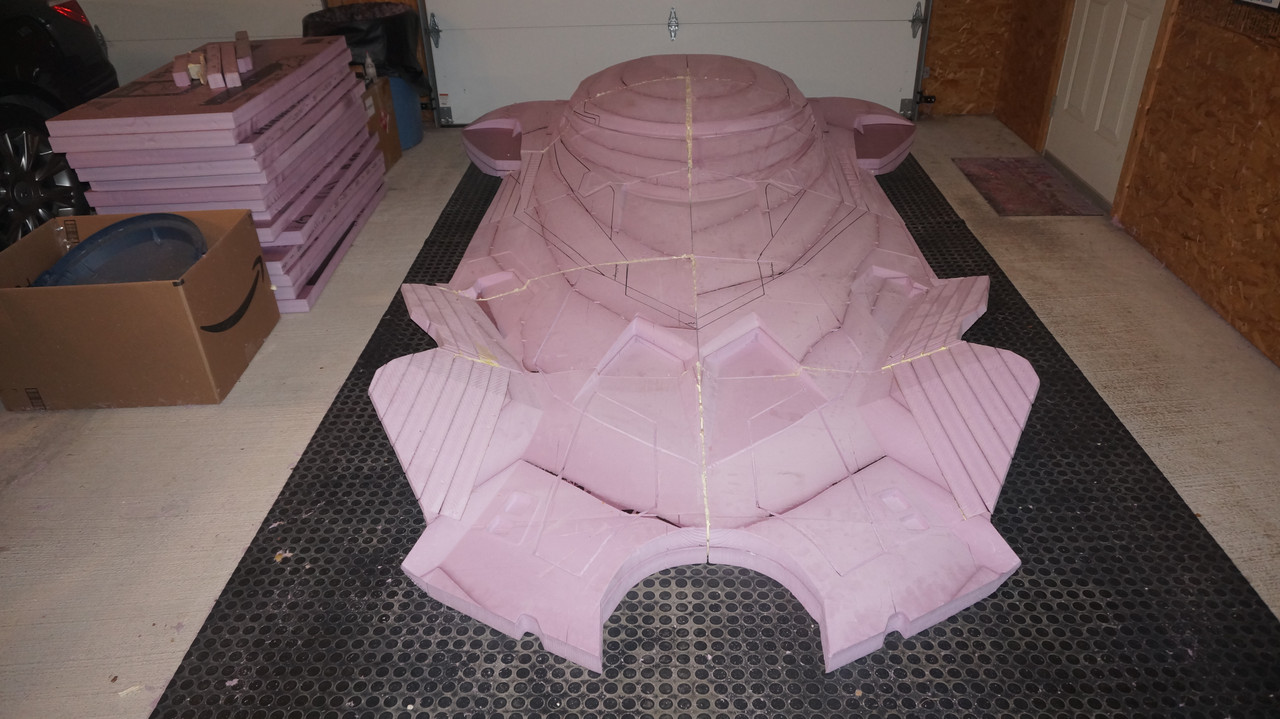

Moving right along, next section milled. It includes the front wind shield and the start of the side jet air intakes.
Starting the next section, which will include most of the cabin doors and the front of the actual side jet air intakes.

While the CNC machine is working on the next section I spent a little time today sanding in the grooves on the fuselage. Something I learned from my first attempt is to finish the foam before adding the protective epoxy resin covering. It will make for much easier finishing work.

Next section milled. This probably makes the form most recognizable.
And the underside...…….
I wound up using the same method of splitting the body as I did on my last, larger version. I tried the vertical slice method I used on the side boxes before but these pieces were just to small and flimsy. Here's what it came out like.
Not good! And it takes so much time and material. Besides, you can't fiber glass the inside anyway because there would be no way to separate it from the mold. My solution will be to make this as the outside mold and then make a separate mold for the inside of the air intake. There needs to be an inside section because part of it is the body of the car that would be an open space into the cabin without the inside section.
Only two more sections to go on the main body. The next section completes the cabin and the last section finishes the rear of the body.
