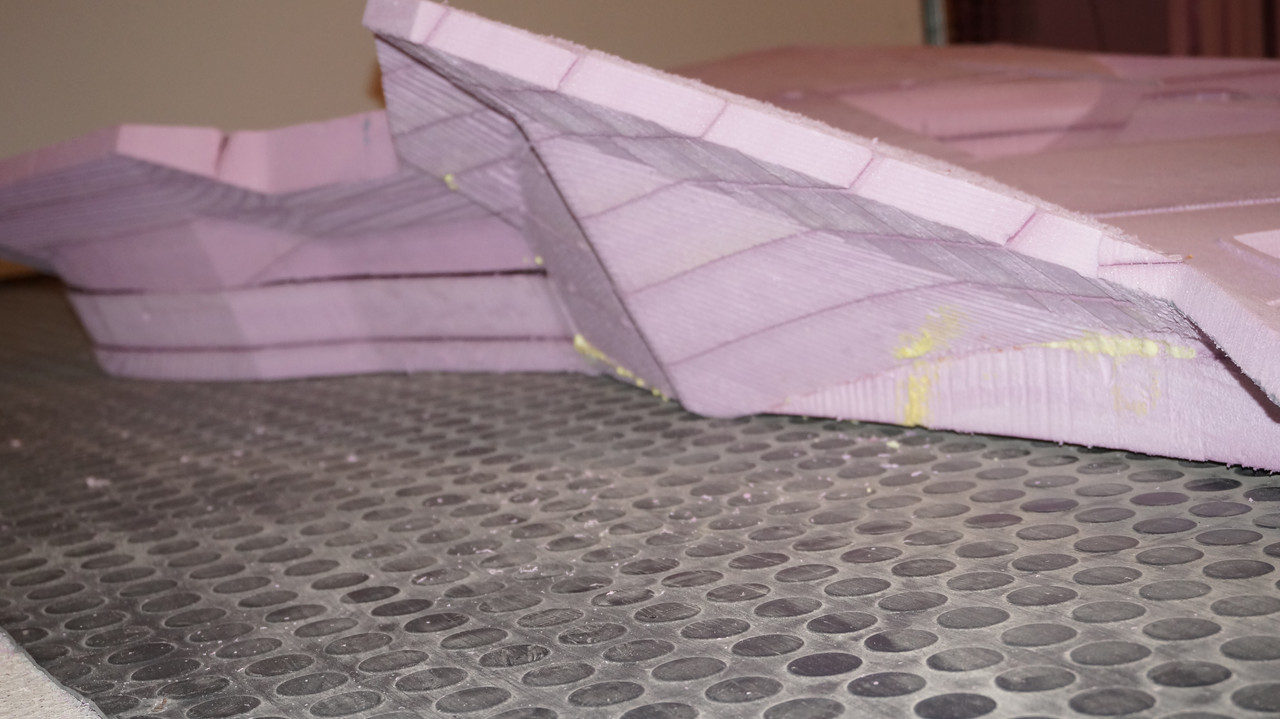

OK, finally got the next layer back milled.
Had a little trouble with the passenger side because of my choice of how to split it. To get the underside I cut the section into top and bottom halves then flipped the bottom upside down to mill it. Seemed to work right on the computer but didn't quite come out right in real life. So used a different method on the driver side that didn't get the bottom part as well.
This picture of the back shows the difference on the underside. I will have to carve out the driver side by hand later.
Next section back will be the front of the cabin and should include the start of the jet air intakes. Hope to have that done by the end of next week. It will also complete the front clip, which means I could start work on making the mold for that part.
