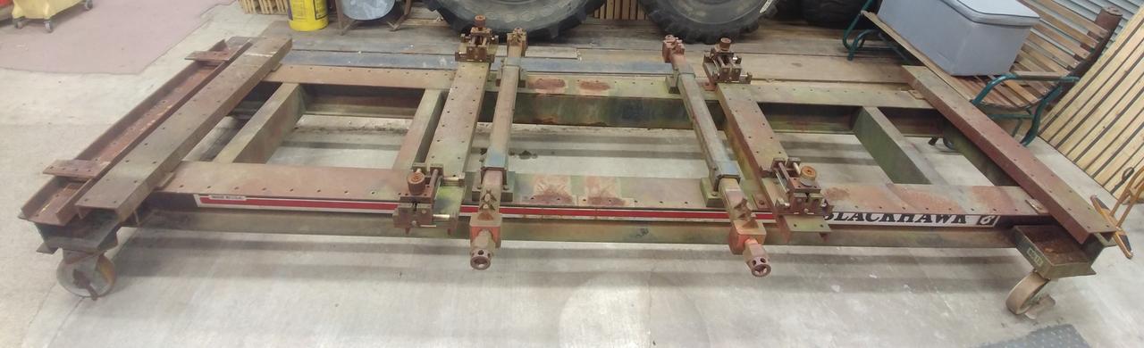

And looky what chassis jig found its home in my lower garage today. Batmobile
Will christen this guy with your ride.

Cool!
The distance from the front of the roll bar to the center line of the wheel on the Vette is about 80 inches. Looking at the .71% reduced model, the measurement from the center line of the wheel on the batmobile to the front center extension is about 87 inches.
That puts the front of the Vette roll bar seven inches forward of where it should ideally be. Now the roll bar on the Vette does come straight up where as the roll bar on the batmobile maintains the angle all the way. If we take that into account I think you're right on with your measurements.

Seems like we're right on track with that, but my suspension design while keeping all the front travel similar to stock does push the front wheel center line forward a few inches... so taking all that into account with your numbers looks really well, and it all has a fudge factor that can be modified before final welding.
