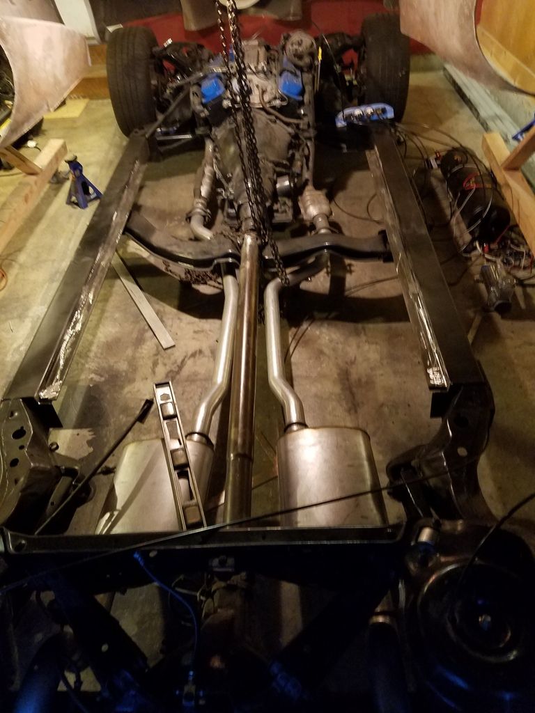

Getting the floor pan set correctly has been a challenge, and taken a lot of welding and manipulation of the header pipes to allow the pan to sit low enough...
we had to remove the factory transmission support as it wont allow us to go low enough..
used 1/4in flat bar as a lip welded on the inside of the center beams to mount the floor pan on:
we have lowered it from this as it was way too high:

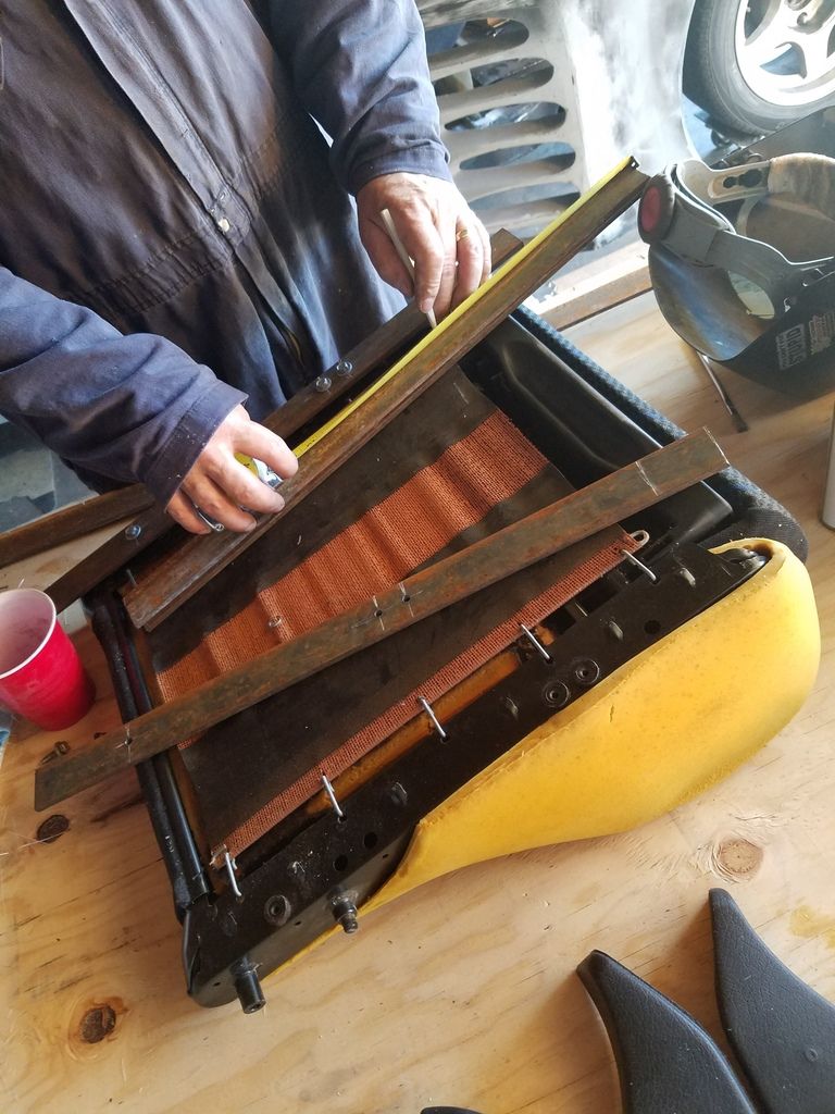

I had initially said I would not fork out money for recaros and went with a cheap alternative...but not only were they sh*tty seats....they really didnt fit in there....so I went on ebay and found a pair for less than 300$ and it only needed to be reupholstered, which I would have had to do for the other seats anyway, so this was a great find...we are working on the seat mounts now...using 1/4in flat bar...

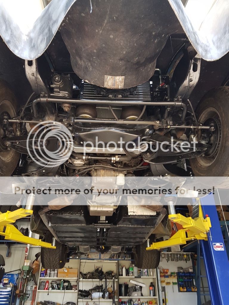

So as I dropped my floor pan quite a lot, i then had no room for the exhausts to travel under the car
easy fix for that was to run them under the chassis rails, and beside the floor pan. Worked out great.
And out the back I didn't go up and over the diff...I went straight under it
